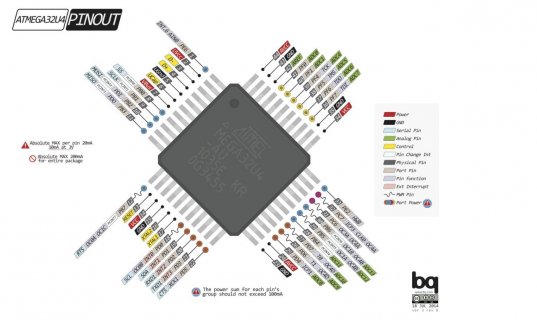

Just to let you know the Teensy 2.0 (ATMega32U4) has 4 INT External Interrupt and 8 PCINT Pin Change Interrupts.

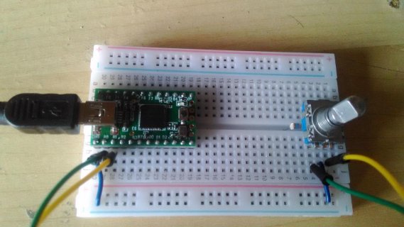

Thank you both. I have now been able to make the encoder work using the attachinterrup function. Not sure what happened yesterday as I used exactly the same code (just rewired my breadboard...), and ... yes probably in my case polling may even be fast enough for my encoder to do their job. It 's also good to know what are the applications that really need interrupts. However while I am working on this project I also I wanted to learn how to properly use interrupts so may be helpful to clarify these issues.
I have pasted below the code I am using. I have commented out the enableinterrupt function and the code as it is works well both with arduino and Teensy (clearly I need to change the variables outputA and outputB to make them match the right pin). However, using the enableinterrup function only works with arduino. If I try to use it with the teensy it will not let me compile. Now if Teensy has PCINT in the pins PB0 to PB7 why would this not work? I suppose I would need to use the values 0 and 1 for outputA and outputB as they would correspond to PB0 and PB1?
I have also attached a pic of my breadboard connections when using pin 0, 1 and 5,6.P_20180325_142554.jpgP_20180325_142525.jpg

Ok I was wrong on the INT External Interrupts available, there is actually 5 External Interrupts on Teensy 2.0

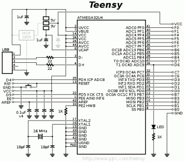

Unfortunately you need to access the interior pin 24, INT6 (marked in red color).
External Interrupts (INT)
Board Digital Pins Usable For Interrupts :
Uno, Nano, Mini, Atmega328-based 2, 3
Micro, Leonardo, Atmega32u4-based 0, 1, 2, 3, 7
Teensy 2.0, Atmega32u4-based 5, 6, 7, 8, 24 --- (5 INT) External Interrupts

Where did you find about INT 6 on pin 24? and is't it strange that they call it INT6 (if there are no INT4 and INT5)?
