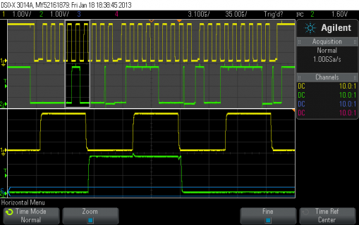

Believe me, I tried to get those internal pullups enabled. It should be possible, according to the chip's documentation, but there seems to be a bug in the chip where enabling the weak pullups while in I2C mode causes an extremely strong pullups (basically driving the line high).
Even if the internal pullups did work, they might not be strong enough. The ones in AVR are just barely able to make I2C work with moderate length wires to 1 chip.
Here's how the signals look using 10K resistors. This is a Teensy 3.0 and a Teensy 2.0 connected together on a breadboard.
Changing to 1K resistors dramatically improves the signals:
Thx Paul, i will add 1k external pullups and see how that goes.
