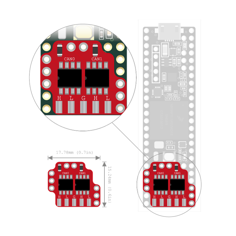

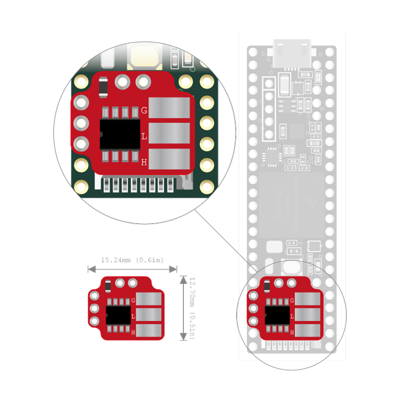

I will have these shields coming in in a couple days.
Looks like we're going to need CAN.setTX(pin) and CAN.setRX(pin) in the FlexCAN library....
That could cause people trying to use any pin for CAN. I would rather think of some kind of CAN.setAlternativePins(alt) that would only allow to chose between alternative pin sets.
Regarding the CAN shields itself I would suggest to add a hole to the CAN pads so one could also use through hole connectors (pads are not mechanically strong).
I didn't do TH because the will be mounted with low profile headers and will sit directly on the (metal) SD slot, adding minimum height to the setup. I've never had pads tear off on me, although they probably won't take as much stress as the TH.
I fully understand why you went for the pads and I do like the design, I was only suggesting adding TH (next to the pads) to make it more universal if you decide to share the design at some point (for those who would like to install the shield underneath on leave a bit more clearance when installed on top.
Regarding the alternative pin selection in the FlexCAN library I think I'll add extra parameters to the constructor (as it is actually the place where the pins are configured) rather than providing separate function for it. I guess it makes more sense that give the ability to change it on-the-fly with set methods.
