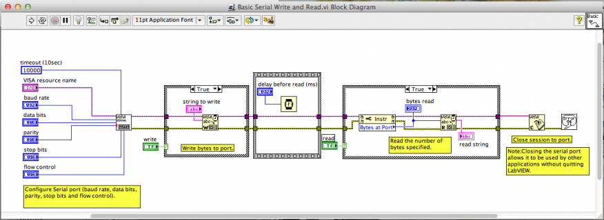

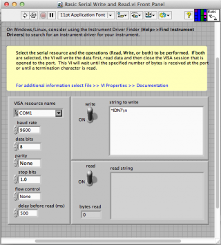

Some labview terminology for you:
1. Programs are called VI's
2. "Front Panel" is where you interact with the program:
3. "Block Diagram" is where you do the programing
4. Once installed there are examples for basic Serial communications and setting Serial Breaks, if you select "Help" drop down, then "Find Examples..." this should show up:

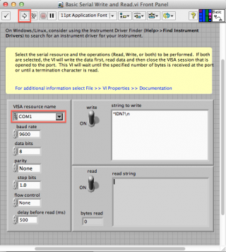

Screen Shot 2014-03-18 at 7.11.56 PM.pngThen search for serial. These screen shots are my Mac but should be the same for windows.
5. To run the VI, select the right COM port and just click the Run button, I outlined them in red:

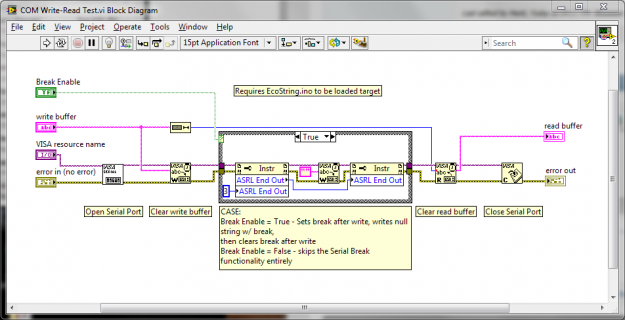

The test case is very simple.
EcoString.ino - as posted on the ni.com LIFA forum.

The LIFA LabVIEW libraries use a Serial Break during the initialization. Why? Dunno. That's just where I found it breaks.
On some test equipment, I believe it's the equivalent of 'Attention!', but I don't know that. I've always been more of a GPIB guy rather than RS232 serial. Why it's used in this case, see above.

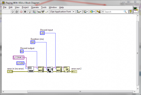

The Serial Break is actually a VISA function (vi) used in LIFA. I dug down into that and found where it broke. To simplify it, I wrote a sample vi to test it.
Digging down into the VISA Break vi gives a slightly more complex version of the "COM read-write.vi". Same error at the same place of both vi's. Mostly my simplified version doesn't have an adjustable break time (250msec by default). I didn't see changing the time make any difference during my tests.

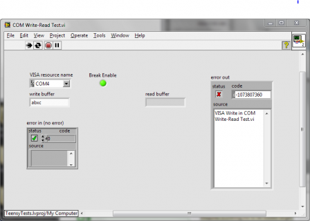

Ok, I got Labview installed and loaded your vi. I clicked "Run Continuously". I typed COM3, but I can't seem to get it to do anything.
Here's what I've got on my screen?
Am I missing "NI VISA"? Or did I do something wrong?
Edit: I found this page about NI-VISA. I'm downloading it now. Was I supposed to also install this? Remember, I have never used Labview before (and I rarely use Windows either)

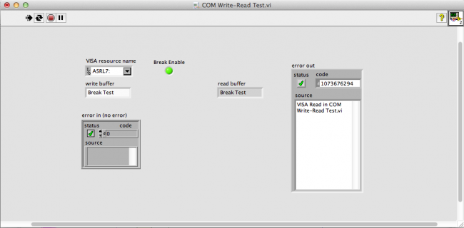

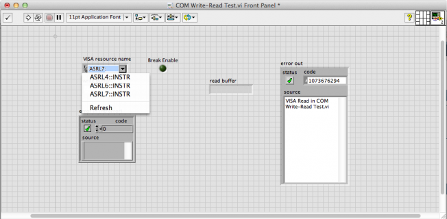

select "visa resource name" and click the com port the teensy's on.
Screen Shot 2014-03-20 at 4.24.52 PM.png mine is mac so "COM?" is different.
Click the "Break Enable" button. It should turn green like the pic below.
then type something into "write buffer" and hit Run or Run Continuously, you should see what you typed in the "read buffer". I don't see any errors on my machine.

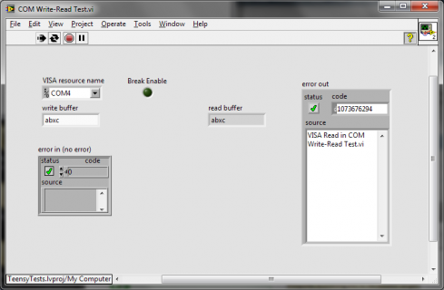

@duff: Interesting. I guess that's not the first time Mac and PC don't act the same :)

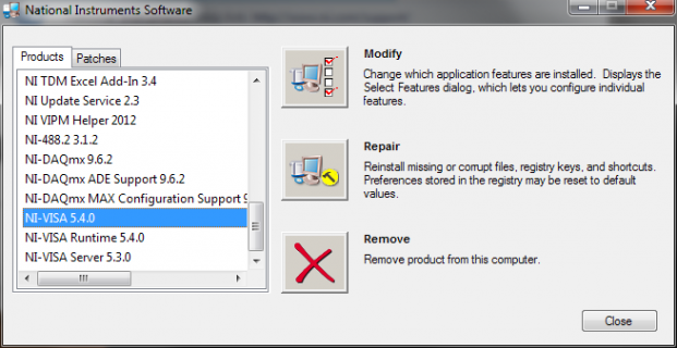

@Paul: If it's not giving you an error, the demo install probably already installed NI-VISA by default. To check go to Control Panel, Programs and Features. Select "National Instruments Software" and click "uninstall / change" (win7). You should see NI-VISA in the listing if it's installed.

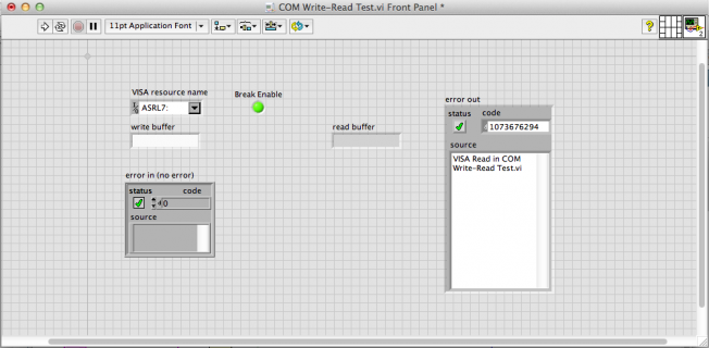

When mine runs, it looks like this with break on:
Break off:
I'd like to see what mknix gets...
Mark, where is the error hitting on, turn on "Highlight Execution" or put some probes on the error line.
