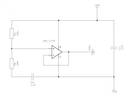

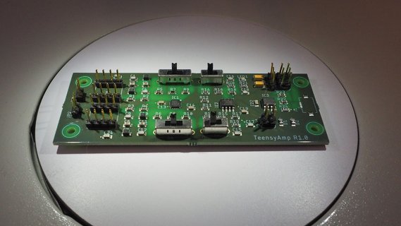

Hello Everybody,
I'm trying to assemble a two-stage instrumentation amplifier for differential analog signals to be recorded single-endedly on the teensy 3.5
My colleague Avner Wallach has created this circuit design for this purpose (the resistors and capacitors for filtering are just a suggestion):
These are the core components:
For recording the signals on the Teensy 3.5, I use a sketch that uses DMA to save incoming analog data to a buffer which is then flushed regularly to the SD card:
While the amp circuit performs well when I read its output with an oscilloscope, I haven't been successful in recording the signal on the teensy.

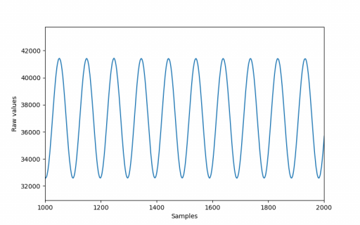

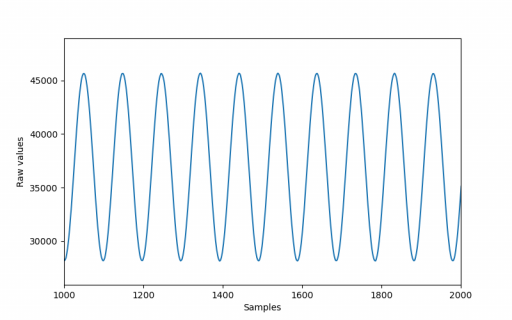

We tried the following configuration:
The results are completely shifted sine waves that are clipping/jumping from the minimum to the maximum:
ADC0:
ADC1:

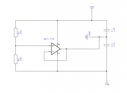

I guess, I must have made a mistake in wiring or shifting the input level but at the moment, I can't find where I'm going wrong here. Can anybody help me out?
One thing that I noticed is that I should maybe connect the level-shifted GND (2.25V) to the Teensy, to set the analog zero? Only, if I e.g. connect it to the Teensy GND, I get weird results:
ADC0:
ADC1:
If I feed one input channel to the differential input for ADC0 (A11) and use the 2.25V GND as second input (A10) and use a teensy sketch for differential recordings, I measure an okay sine-wave with occasional clippings in the negative phase:
Obviously, this defeats the purpose of having a differential amplifier at all... Does anybody have a suggestion?

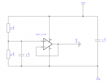

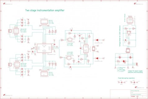

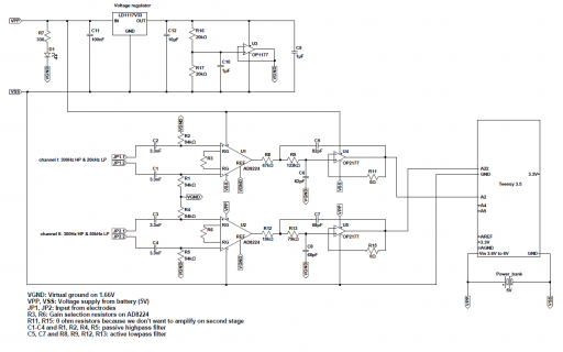

- AD8225: first stage differential amplification
- OP2177: second stage OpAmp
- OP1177: level shifter (raises GND to midpoint between VSS and VPP)
- Passive RC highpass filter on input stage
- Sallen-Key lowpass filter on output stage
- Power supply: 4.5V (VPP = 4.5V, VSS = 0V, GND = 2.25V)
- Input signal: 1kHz sine wave, ~ 100mV peak-to-peak amplitude
- Amplifier settings: 5x gain, 300Hz highpass and 20kHz lowpass filter on ADC0; 10x gain, 300Hz highpass and 50kHz lowpass filter on ADC1
- Teensy was powered by VPP (on VIN) and VSS (on AGND)
- Recording settings: 100 kS/s, 3.3V internal reference
ADC0:
ADC1:
ADC0:
ADC1:
