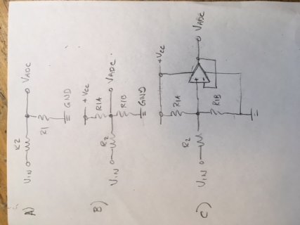

Hi 128-
Rather than jumping straight into op amps, why not start with your requirements and work up to what you need?
Sounds like you want to match a range of ±12V (24V total span) to the 0-3.3V range of the ADC. As Paul suggests, you may also want your circuit to work with a standard 10x oscilloscope probe. This means your input should "look like" a 1 Megohm resistance to ground from the outside (in parallel with about 20 picofarads capacitance; we can come back to that later). So, (1) you want 3.3/24ths of the input voltage to appear at the ADC pin; and (2) the total resistance should be 1 Meg.
Start with a 2-resistor divider: draw a resistor R1 from the ADC pin to ground, and another R2 from your input to the ADC pin.
From (2) you then just need R1+R2 = 1 Meg (we are going to assume the ADC has a very high resistance, much higher than 1M).
Then from (1) you want xxR2/(R1+R2)xx R1/(R1+R2)= 3.3/24. You should check my math, but I believe this gives you R1 = 137.5 kOhms. You will have to round off to available R values, and if you need precision, you may need to include a trimming potentiometer (as you have in your opamp circuit). Remember, though, that
this is going into a micro controller; it's almost always better/faster/cheaper to trim and calibrate digitally.
But you wanted ±12V, centered at zero, whereas the ADC can only see 0 to +3.3V. So let's add half of 3.3V to the answer. One way is to split R1 into equal parts, say R1A = R1B = 2* R1 (275 kOhms each in this example), and connect one end to ground, and the other end to the 3.3VDC supply.
The divider still works in the 24:3.3 ratio, as "in parallel" it's still the same value; but your reference (corresponding to "0V" at your input) is now centered halfway up the ADC range.
Depending how fast your signals are, this might be enough. But if you are looking for fast response (say, audio or faster), it won't perform that well. First, with the scope probe you do need to add the 30 pF or so the probe expects to see; this will compensate the capacitance across the probe, which is trimmed to make the ratio of C's and the ratio of R's match.
The other problem is the ADC; such a high impedance input circuit (over 100 kOhm) will slow down settling of the ADC input, due to its own input capacitance (maybe 10 pF or so). I believe, to reach rated conversion speed, your ADC wants to be fed by something less than 5 or 10 kOhms.
So again, look at your requirements. If you need speed, can you sacrifice input impedance? If your oscilloscope project can have, say, 10 kOhms input, instead of 1MOhms, then just reduce all the R values above by 100x.
Otherwise, if you need both speed _and_ high input impedance, you might need an opamp after all. Good place to start (and what is actually used in real oscilloscopes) is simply a x1 buffer between the above moderately high-impedance junction of R's, and your ADC pin. This will just copy the signal, but with a very low output impedance able to quickly satisfy the ADC's thirst.
You might even be able to use a "rail-to-rail" opamp (e.g., LT1366) that can accept and deliver voltages right up to its own supply rails. Then you could maybe use the 3.3V supply from the Teensy without adding an external supply.
Hope this helps!
mike

Good catch, hadn't had my coffee! So you did check my math, awesome ;^)
I edited #4.
Not sure how to draw a readable picture in here, the editor mangles ascii graphics. Let's try a cell phone picture.
First example A (where R1 ~ 137k, and R2 ~ 863k) and then, to fix the DC offset problem, example B (where R2 is still 863k, and R1A = R1B = 275k each).
But for that bandwidth, yes you may need a buffer (C). I noticed your original has 10k input impedance, if that was really acceptable it really is perhaps as easy as the three resistors. But if you need the buffer, this would just go between the junction of the three resistors and the ADC pin. You'll also likely need to compensate the capacitance of a probe (if used), and maybe also the input C of the buffer.
BTW another opamp to consider might be LTC1638 (1 MHz dual, micro power, rail to rail in/out).
In each case (with or without a buffer), the Teensy is protected by either a) having a large series resistance, so very little current can pass into the ADC pin if there's an over/undervoltage, or b) restricting the voltage swing to the allowed input range. As Paul indicates, if you do use an amplifier with higher supply rails, you should add additional circuitry to insure one or both conditions are satisfied.

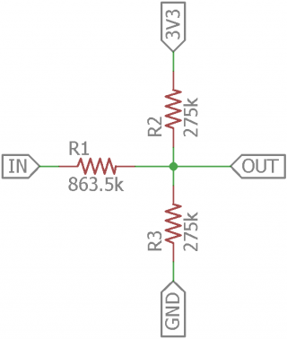

Thanks for the clarification, However in the simulator, if I apply a sine wave to the input of this circuit with 12V and -12V peaks, the result is a sine wave with 3.07V to -225mV peaks:
Maybe I interpreted your description wrong.
Edit:
Saw your picture now, Should I check your math again?:rolleyes:
maybe the dc offset should be implemented in the op-amp instead? this however will require a -3.3V rail which may be problematic
Wow... I feel so dumb now that I am designing op-amp circuits but can't even analyze this simple 3 resistor circuit... looking at it for an hour and I can't figure out whats happening there. even after changing all R's to 1 ohm, Vcc to 1V, and Vin to 3V I'm getting 1.33V at the output and have no freaking idea why. Please guide me through this.
OK 128, no worries. Suppose you allow the pair R1A and R1B to be not quite equal anymore. In fact, suppose they're the two legs of a potentiometer, and the ADC node is the wiper (close to the middle, but variable). Tweaking the ratio R1A:R1B a little will change the DC bias point a bit, no? Shouldn't take much to cancel out your 225 millivolts.
Of course you can play with this in your simulation. However a good trick to think about it (or any mess of resistors and voltage sources) is to make the Thevenin equivalent for each piece.
I suggest looking at any edition of Horowitz and Hill (e.g., https://archive.org/details/TheArtOfElectronics-2ndEdition , page 11) if this concept is unfamiliar (in which case congratulations, you're in for an "AHA!" rush!).
For example, let's combine R1A and R1B and the DC supply Vcc. With Vin and Vout left open, the equivalent Thevenin voltage Vth = Vcc * R1B/(R1A+R1B) (I think I put R1B on the bottom in that diagram) But if you now short Vout to ground, the current that flows will be Ith = Vcc/R1A; so the Thevenin resistance of that part of the circuit must be Rth = Vth/Ith = R1A*R1B/(R1A+R1B) = R1A || R1B. (Which is kind of convenient, because remember we already chose R1A || R1B to equal the old R1, to make the correct divider ratio with R2; we thus know what it should be).
Now the whole circuit looks like just 2 series resistors (R2 and Rth = R1A || R1B). Your input goes to R2 as before, the Thevenin equivalent voltage source Vth connects (like a battery) to the far end of Rth, and the center junction between Rth and R2 goes to the ADC.
From here it shouldn't be too much work to find that, for your ADC to see Vcc/2 when Vin = 0V, R1B needs to be about 38% bigger than R1A (again, check my math! my 'simulator' is old, grey mush!!).
If you are super OCD, you can then scale the 2 resistors by a bit to continue exactly satisfying the other 2 constraints; and then, develop series/parallel combinations to make up the exact R values you calculated from available stock values. Taking account, of course, of each resistor's temperature coefficient... blah blah blah...
OTOH, if you are like me, you will dig up 10k, 3.3k and a 2.4k resistors (5% values many folks would have on hand), hook up your Teensy, and get on with the fun part.

Thanks for this help! I was in a real "AHA!" rush, since I have never heard about this Thevenin theory, and It helped me to solve this.
Firstly, the 2 resistors divider equation:
(difference in voltage X resistor divider formula)
Then I can plug R1A and R1B instead of their Thevenin equivalents:
And then plug Vout = Vcc/2 and Vin = 0, and after playing with the math I get R1B/R1A = ~1.38
I want to thank you again for this guidance, learned a lot from it in the last days!
