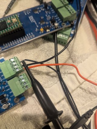

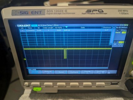

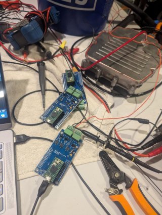

I pulled the logic analyzer out and captured the 3 frames to the heater, using this code:
C++:
// write ID33 register
  uint8_t lindata0[] = { 0x00, 0x08 };  // chechksum 0, counter 0, HvCooltHeatrEnadWhE2EHvchEnad = 1
  lin.order(0x33, lindata0, 2, lin2x);
  delay(100);
  // write ID22 register, HvWtrHeatrPwrCnsAllwd = 0
  uint8_t lindata1[] = { 0x00, 0x78, 0xFF, 0xD0 };  // 0W power, 80C target temp, max flow, enable
  lin.order(0x22, lindata1, 4, lin2x);
  delay(100);
  // write ID22 register again, HvWtrHeatrPwrCnsAllwd = 1000W
  uint8_t lindata2[] = { 0x19, 0x78, 0xFF, 0xD0 };  // 1000W power, 80C target temp, max flow, enable
  lin.order(0x22, lindata2, 4, lin2x);
  delay(100);
First message, to ID33:
Second message, to ID22:
Third message, to ID22 again:
All looks as intended. Since I'm measuring on the Teensy Serial3 TX pin, you may want to connect your oscilloscope on the actual LIN data line near the heater's LV connector and verify whether the data is actually making it up to that connector.
If that also looks good then the next step would be to share the captures and the code with the engineer for verification.
Paul.

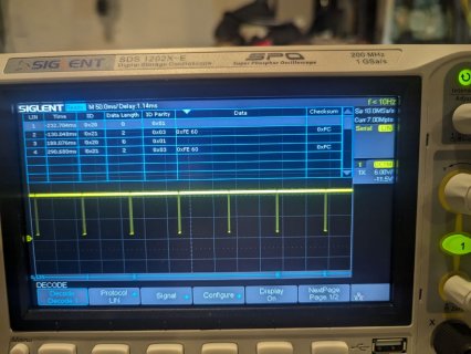

Thanks Paul. I will do this and report back. Hopefully my oscilloscope settings from the last time will still be intact. I will make sure the baud rate is correct. Do you know if I can use my CSS CL1000: CAN Bus Logger & USB Interface along with SAVVYCAN to capture LIN signals?
Also, in the manual I saw this under the error sections and wondered if this also provided any clues:
17 Communication fail.
The LIN bus cannot receive correct bus data within 1600ms, the system LIN timeout fault is set to 1, the
controller stops sending heating power, and it recovers immediately after receiving valid LIN bus data.
If Lin communication has no bus activity for more than 4000ms, it will enter bus sleep and stop working.
Normal operation automatically resumes when bus activity resumes.
When Lin communication receives a data error, the controller generates a LinResponseError fault and reports
the fault unconditionally.
So I ran the below code:

I moved the lin.order code to the loop. Otherwise, I was getting nothing. I am getting strange results:
0x33 never shows up
0x22 never shows up BUT when I isolate to just the first 0x22 command, I get 0x21 with your power at on the oscilloscope and with the second command I get 0x20 or 0x00 depending on what value is in the power slot (0x19 vs oxB4 for example).
I am using multiple teensy boards to make sure it is not a board issue and my oscilloscope is taking a reading at the lin out from the teensy.

Hmm, strange results.
Tomorrow, I will hookup my SK Pang LIN-Bus Breakout Board and check with the oscilloscope as well.
With respect to the use of the CSS CL1000: I don't think it's usable since it is a CAN bus logger only.
Paul
