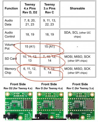

When using the audio adapter with the 4.1,
how many of the pins must be dedicated to the adapter interface?
If the settings card is not used, can those pins be used for other purposes?
What about the memory chip and volume control pins?
If you look at the schematic, you will see pin 15 has a 0.1uF capacitor and a 25K resistor on it. I believe these are to make analog inputs smoother.
Both pins 6 and 10 have 10K pull-up resistors that are typically used on SPI CS pins.
Pins 18 and 19 have 2.2K pull-up resistors that are needed for the I2C bus.
If you connect pins 6. 10, and 15, then these resistors and the capacitor may interfere any other uses of the pins.
Due to the fact that the revision D and D2 audio boards were made from the revision A-C audio boards, and just changed what pins are used, the 2 SPI devices (memory and SD) use the ground pin next to pin 0. While the volume control uses the ground pin between VIN and 3.3 volts. On the Teensy 4.0 and 4.1, these 2 pins are connected, but on the previous Teensy 3.0, 3.1, 3.2, 3.5, and 3.6 boards, the pin between VIN and 3.3 volt was the analog ground pin. I.e. you need to connect both pins to get the audio board to work completely.
It depends on what you are wanting to do with the pins. I would say the simplest approach is just not to connect pins 6, 10, and 15 between the Teensy and the Audio board, and then you should be able to use the pins in whatever fashion you want. If aren't using either the memory or the SD card, then you don't need to connect pins 11-13, but if you don't connect pins 6/10 and do connect 11-13, you should be able to use other SPI devices.
Obviously, pin 13 still has the LED on it, so that might affect things if you want to do a digital read from pin 13.
So if the I2S is handling audio in and out and those are bussed to usb audio (in and out) I can reassign chip selects for the memory chip and SD?
