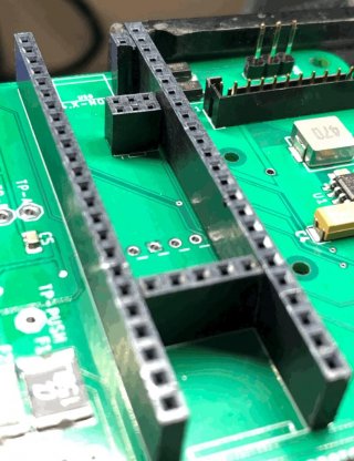

I am making an addon pcb for the teensy 4.1 which will need to passthrough the 48 outer teensy pins along with the 6 ethernet pins. I will use two of the 24x1 Sockets on the pjrc store to pass through the teensy pins but I am still searching for which components I should use (pins + socket) for the ethernet. Has anyone made a board in which the teensy is plugged in to a socket which also has a socket for the ethernet pins to be passed through? If anyone has experience or suggestions it would be greatly appreciated!

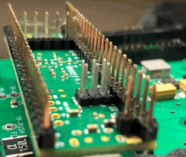

I tried this recently, not an ideal solution, but it works mechanically. Haven't ran ethernet thru it yet, that's further down the road.
The 2mm female sockets are shorter, so I had to use longer male pins. The ones I found were too long, needed to push the plastic down using a press and snipping the excess after soldering.
I used the following parts to make it work, cutting down the parts and sanding as necessary. It's quite a bit of work to do one board. When it's done, it's a lot of pins to pry apart, so you have to carefully and evenly pull it apart.
S1011EC-40-ND
SAM1213-24-ND
SAM13316-ND
SAM1245-03-ND
