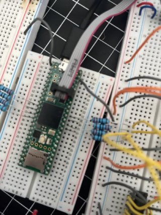

I'm currently experiencing some major lag on my LED setup. My current project specifications:

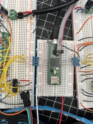

I have 4 LED strips, each 300 pixels long. Each strip is going to a separate pin on the Teensy.
With just 3 strips (Art-Net universes 0-1 to 5-140), the LEDs work really smoothly. The data comes through from Mad Mapper, and the effects show nicely. All 3 strips operate mostly fine, although very fast effects seem to drop some data. However, when I add the 4th strip (Art-Net universes 0-1 to 7-16), everything comes to a grinding halt. I'm a bit stuck on this one, and can't find much insights around after extensive searching. I'm assuming that I should be able to drive a lot more pixels over Art-Net based on the notes in the OctoWS2811 library.
Further notes:
In my circuitry, each data pin feeds into an input on the 74AHCT125 level shifter, and the output feeds into the strip. It's properly grounded and powered, and tested without Art-Net (using FastLED) just for safety.
I'm using the sample code from the OctoWS2811 library… the only difference is that I swapped out Ethernet and EthernetUdp for NativeEthernet and NativeEthernetUdp.
And in Mad Mapper, here's my DMX settings:
Any help would be greatly appreciated.
Thank you!
