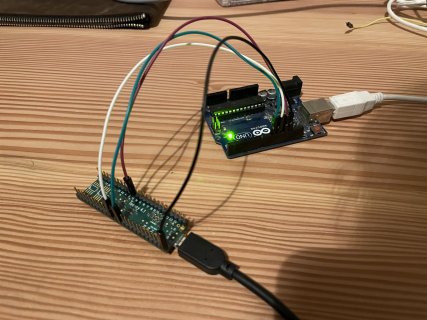

So I am trying to make an Arduino UNO (master) and a Teensy 4.1 (slave) communicate via SPI. More specifically, the UNO sends the Teensy a byte every second whereafter the Teensy prints the byte to the Serial monitor (I intend this to be some sort of MVP for a bigger project to make sure the communication works fine). Since slave mode is not officially supported for the Teensy 4.1 I am trying to make it work using this library by tonton81 https://github.com/tonton81/SPISlave_T4 and a forum post by tjaekel https://forum.pjrc.com/index.php?threads/teensy-4-1-spi-slave-here-it-is.72792/.
Unfortunately, I am having some issues with the data transmission, namely the Rx buffers do not seem to be filled although the Receive Data Flag (SR) is set properly.

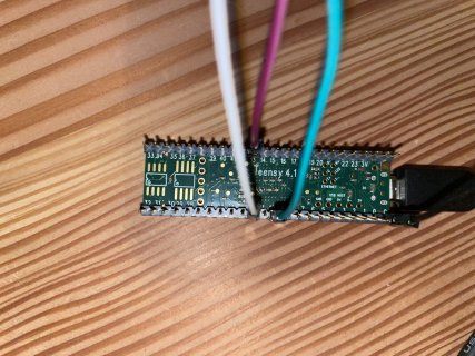

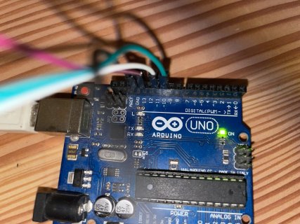

Wiring (UNO to Teensy), photo attached:
- Pin 13 to Pin 13 (SCK)
- Pin 11 to Pin 12 (MOSI, Note: According to tjaekel's post, the pins MOSI and MISO are swapped here)
- Pin 10 to Pin 10 (SS/CS)
- GND to GND

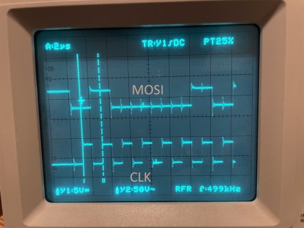

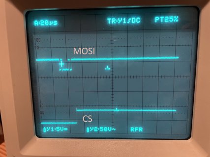

- Verified correct data transmission by the UNO using an oscilloscope (as can be seen in the pictures attached)

Correct me if I'm wrong but the Uno uses 5V? Do not connect 5V signals to the Teensy! It can only handle 3.3V and will be permanently damaged.
The T4 is absolutely _not_ 5V tolerant, 3.3V is the limit for all pins - this is clearly stated in the data for the device. You require level converters to talk to a 5V chip (if you haven't fried the T4 already).
Haha, awesome! I was sitting there hours on end but I forgot the most important aspect. After a few checks my Teensy seems to be fine despite the high voltage. Unfortunately, I haven't got a logic level converter at hand right now but I tried it with a simple voltage divider instead since I only need 1MHz max and it actually works! The Teensy successfully receives the data. I am a bit surprised that the high voltage caused the MCU to detect no data at all as I expected it do read at least something (frying the board in the process). But I won't complain. It works without any issues. Thanks a lot and the thread appears to be already finished here!
