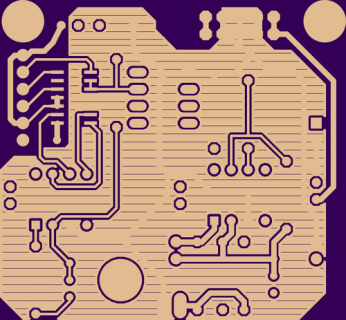

PCB
Normally my next step would be to breadboard the circuit to verify that it works as expected. However, the chosen DAC (and indeed most modern high performance DACs) is a surface mount part, in this case SOIC14. The connectors from the Fatar keyboard are also not breadbord compatible, being Micromatch connectors with a 0.05inch pitch. So I need to make a PCB. Started to learn KiCAD, gave up, went with Eagle since thast has a lot more parts libraries and seems to be waht most people use.
After one failed attempt of laying out "everything on one PCB" I have split the task as follows: one PCB for Teensy++ 2.0, micromatch connectors, two sets of SPI (with different chip selects) and one set of I2C. One PCB for the 16bit pitch CV output. That gets me started for testing and code development, and the other parts (I2C ADC and second SPI DAC) can be added later.
The two PCBs pass electrical rules check (once I ignore some warnings about VCC connected to 5V, GND connected to DGND, etc) and also passes the OSH Park design rules check. However they are my first self-designed PCBs so I would appreciate more experienced eyes than mine giving them a once-over before getting them fabbed.
DAC board
Schematic
Teensy++ board
Schematic
Eagle files in github. For some reason Eagle uses a plain rectangular symbol for a dual op-amp rather than the normal two triangles. I'm aware that the silkscreen layer is an overlapping mess; I have not learned how to clean that up yet.
