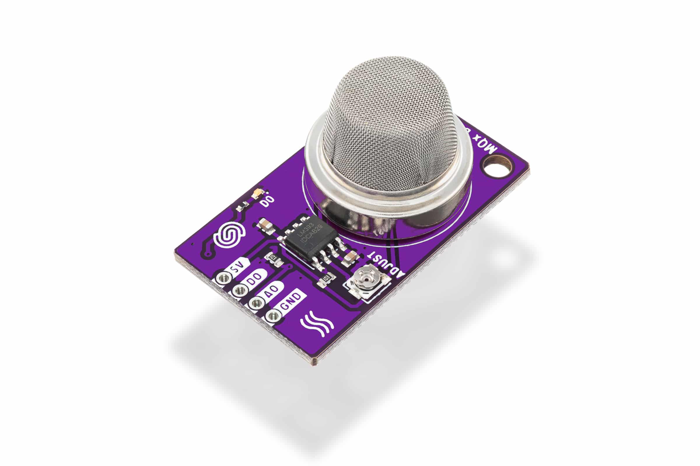

Hello Everyone, i am new with teensy and beginner with arduino, currently i am working on teensy4.1 and EVAL-AD7124-8SDZ, the board has SPI pins as test points / solder points, and i am trying to establish a connection with this pin. the board already has a power supply of 7-9v, and i am powering my teensy through usb. my aim is to connect a MQ-8 sensor on the 24 bit ADC, but before that i am trying to slowly achieve the basic SPI setup. The following are the pin connections
TSCLK - PIN 13 of teensy
TCS - PIN 10 of teensy
TDIN -PIN 11 of teensy
TDOUT - PIN12 of teensy
AVDD - VCC of MQ8
AVSS - GND of MQ8
AIN2 - A0 of MQ8
i connected the teensy GND to the GND of ADC board.
For the first instance i have code to just read the ID register 0x05, which has a value 0x17 but i do not receive this value. this means i have not established a SPI connection successfully. i am trying to troubleshoot this but if you find any mistakes in the code or approach please correct me. thank you i will have the code and important links below.
