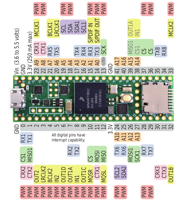

You can't just choose any spare pin. Only certain pins can transmit digital audio.
The pin functions are documented in 2 places. First is the pinout card, which comes with Teensy 4.1 and can also be found on the Teensy 4.1 product page, and also this page.
https://www.pjrc.com/teensy/pinout.html
The digital audio pins are shows in yellow.
While this serves as reference material, the compact format doesn't really communicate the finer details of exactly how you can really use these pins. For that sort of detail, you need the 2nd main documentation source.
