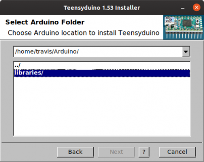

I am having a technical problem using the teensyduino installer for linux. When I am at 'Select Arduino Folder' part of the install it does not recognize the arduino folder and the 'next' button is grayed out. How do I get past this?
Thanks.
Download a fresh copy of Arduino from Arduino's website:
https://www.arduino.cc/en/Main/Software
Extract it. But DO NOT extract it inside of that Arduino folder (which looks like the place you save *your* programs). Put it in a different location, and remember where.
Then run the installer again and select that location. The "Next" button will activate when you select any location which contains a supported copy of the Arduino software.
If you want to know *why* the installer isn't activating the "Next" button, click the small "?" button. But ultimately the answer is the same. You need to have a supported copy of the Arduino software and select the location where the software is installed, not the location where it would save the programs you write.
How did you install the Linux version of Arduino? if you did something like sudo apt-get install Arduino... This type of Arduino won't work.

That looks like your documents folder - i.e. where you would make sketches and install libraries. Teensyduino is asking for the install location of the arduino program. Typically this would be in something like /usr/local/arduinoXX where XX would be the arduino version number.
