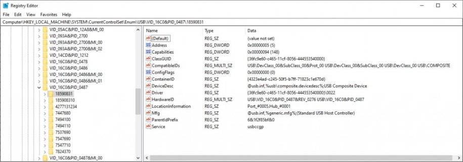

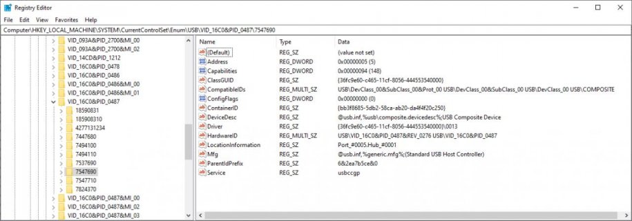

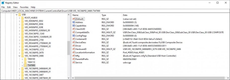

Hello Graham,
Both working and none-working joystick setup use the drive filename usbccgp.sys
I opened each items in Regedit which may provide more information.
This one is the active joystick that is not working because it has the same SN as another inactive instance
This one is the other instance sharing the same serial number which is not active
This one is the active joystick with a different serial number which is working well
I think that may just be the generic driver that comes into play for composite USB devices, which then loads other driver(s) for the individual features.
As you noted, in the registry, the entries corresponding to the misbehaving serial number 7547690 appear under both VID_16C0&PID_0486, and also VID_16C0&PID_0487. Whereas the successful serial number is 18590831, and appears only under VID_16C0&PID_0487.
Looking at
C:\Program Files (x86)\Arduino\hardware\teensy\avr\cores\teensy3\usb_desc.h where these items are defined:
PRODUCT_ID (PID) 0x0486 is for RAWHID
PRODUCT_ID 0x0487 is for Serial/Keyboard/Mouse/Joystick
So this raises the questions:
-- Did 18590831 succeed because it has only the one entry?
-- Or did 7547690 fail because it reported to Windows that it had product Id 0486? And does it always report PID_0486?
-- Or did it do that just once, and then on later plug-ins, Windows for some reason uses the 0486 entry regardless of whether the Teensy reports 0487 or 0486?
A possible test:
When you next encounter a joystick that doesn't work:
1. Unplug the joystick
2. Look in the registry to see if it also has these two entries
3. Delete that serial number's key under VID_16C0&PID_0486. So that leaves it with only the key under VID_16C0&PID_0487.
4. Plug in the joystick and see if it now works.
5. Inspect the registry again to see where that serial number has entries.
I am hoping this tells us at least something. But we don't actually know that it's this area of the saved settings that's causing the trouble. The multiple entries might be unrelated to the issue.

Short version of fix
Delete from the registry all keys containing VID_16c0.
-- Graham
Thanks a lot Graham and all the people who fixed this problem in Windows! After years, this thread is still useful! I have 4 Teensy 4.0 configured as "Serial / Keyboard / Mouse / Joystick" (joysticks used for a professionnal helicopter flight simulator) and I experienced the same issue. Impossible to recognize the classic 32 buttons... After changing the Product ID in order to have different GUIDs I finally deleted the registry keys in Windows (HKEY_CURRENT_USER -> System -> CurrentControlSet -> Control -> MediaProperties -> PrivateProperties / Joystick -> OEM & DirectInput) and that worked!
