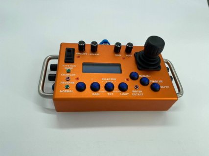

This is a real problem for me because I use Teensy 3.5 to make a professional joystick.
Nevermind that I have to repeat this procedure each time I have to test a new controller on my laptop, but some of my clients buy several joysticks from me and are experiencing the same problems. (Windows 10)
Running this fix is too complicated for them. If the problem cannot be fixed, would it be possible to have an executable file that would flush VID_16c0 out of the Registry?

Thanks, its my biggest seller. The Teensy allows me to do so much more than regular joystick PCBs which gives my product a huge edge over the competition. So I really hope we can get this sorted out since big companies are starting to have this issue and that is a bit of a let down.
