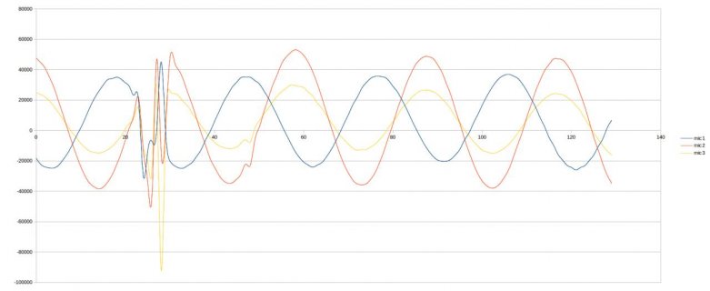

I'm sad because I thought I had it figured out. I am hoping someone can point out what I'm doing wrong.
this code has 5 mics listening and cycling through five 30 value 1-D arrays until an amplitude threshold is crossed, then it fills a 130 row x 5 column, two dimensional array starting at the 30th row index. Then, when it reaches the 129th row index the algorithm starts filling the first 30 rows in the 2-D array from the stored 1-D arrays.
the whole purpose being so that I can send 130 data points per mic, with historical values prior to the sound triggering event (I'm doing this to keep the sound event in the middle of the data set.)
here's the code:
It writes a 0 value if the first 16 bit TDM value wasn't read.
the code works but it's buggy, for example, for some reason the first 30 rows are usually always solid zeros but varies (I thought I was very careful about the array indices and the for loop executions, but I must have messed up somewhere.) and it prints a lot of zero values throughout (a sign that my error checking method to show when the first (MSB) half of each mics 24 bit value wasn't available to read when it checked)
I currently only have 3 mics connected as can be seen in my sample serial printout:
and this is what that looks like:
I have a couple of suspicions of what is wrong, I think I need to handle the reading of the queue in a better way(any sugestions?), and I think I may have screwed up the transferring of the historical values to the final array being sent.
I know you guys have been generous with help already, but I could really use some more help to figure this out.
here's the code:

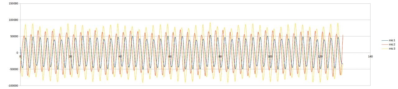

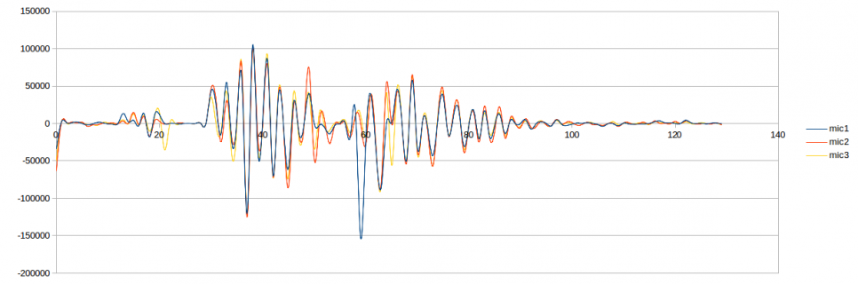

indexWrap = 8
