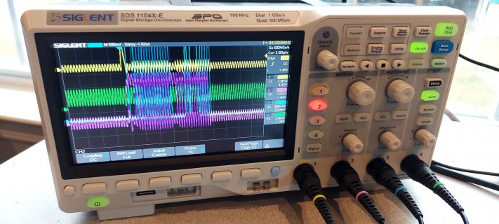

First shot from the scope.
Yellow = LRCLK
Purple = DAC Data (out of mainboard, into 3105)
Green = ADC Output directly from 3105
Blue = ADC Output after buffer
Based on this. It does appear that the buffer has nearly zero delay to be concerned about.

Looking at the PURPLE DAC and the BLUE ADC. It appears that the ADC is coming in yet another 1 bit further than the DAC. I'm not sure if that is to be expected or not. But if this is the case then I would probably need to adjust the Audio Library to receive the ADC at an offset of 2... I don't think my buffers are causing any of that delay because I tested it on both pre and post buffer outputs. The ADC seems to be offset 2 and the DAC seems to be offset 1. I'll also ask TI.

Fixed the BCLK (disconnected ground on the probe). And played a 1kHz sine wave from USB>Mainboard>3105> and from Phone>3105>Mainboard.
Purple is DAC and BLUE is ADC... It seems off to me. The ADC is too far right. TI said this shouldn't be the case. Still trying to find a solution there to.
I2S mode works great with both DAC and ADC. It sounds good. But doesn't this look funny still with the data lines seemingly behind the clock. It should be on the rising edge, right?

Those scope traces are way too slow to transition, perhaps you have your 'scope probes set to x1 rather than x10 (which is required for fast signals).
Hello MarkT,
Thanks for the advice. I didn't know. But you are right, it looks better maybe when 10x is enabled on the probe, and 10x is also enabled on the scope. I presume that's how it's done. My yellow probe is broken, so the 10x switch doesn't work. So I am showing just one signal line at a time.

There is clearly an issue with the TDM mode. The ADC is being sent late.
There must be some mismatch in my ADC configuration. The 3105 must be putting the ADC on the wrong bitrate or something. Hmm.
TI did mention that they find it unlikely that the clocks are at fault. If it works for I2S mode then it should work for TDM mode.
It doesn't look out of specification. For the TLV320AIC3105, td(DO-BCLK) is specified as 20ns maximum at IOVDD=3.3V (section 8.6 on p11), and it looks less than that. For the i.MX RT1060 SAI interface, "S9: SAI_RXD/SAI_FS input setup before SAI_BCLK" is 15ns minimum (table 50 on p60 of IMXRT1060CEC.pdf), and it looks like you've got about 30ns. Assuming here that the green trace is BCLK, and the blue is what you're calling "ADC LINE" aka DO from the TLV320 to SAI_RXD on the i.MX RT.

I'm thinking that the word clock should rise when the bitclock rises, and that's the reason for the issues. Is there a setting somewhere to change the clock timing on the i.MX RT1060 SAI?
While listening more to the DAC, I would say it also is negatively impacted in terms of sound quality over I2S.
According to the TLV320AIC3105 datasheet, WCLK must *NOT* rise together with BCLK.
You can see in figure 3 that WCLK, SDOUT, SDIN are expected to be stable during the BCLK rising edge.
Like all synchronous clocked digital signals, it has a setup time where the signals must be stable before the clock edge (rising in this case) and a hold time where it must remain stable after the clock edge.
With the BCLK period being 354ns, and the setup+hold time being only 16ns, the WCLK (LRCLK) signal is allowed to change at any time during the other 338ns. It only is required to be the correct voltage 10ns before the BCLK rising edge and remain so for 6ns after.
Hopefully it's obvious that having LRCLK change at or very soon after the BCLK falling edge meets this requirement. That also happens to be the way it's depicted in Figure 3 (though as a matter of documentation style, I personally feel showing setup and hold relative to the same clock edge makes a much clearer impression than the way someone at TI chose to draw this diagram). Having WCLK (LRCLK) change together with BCLK would absolutely violate the required setup and hold time. It only has to be stable for 16ns, right at that moment of the BCLK rising edge!
You can change the polarity, and it looks as if it might be worth a try. In output_tdm.cpp there are lines to set the Bit Clock Polarity, e.g. on this line, also here. i.MX RT1060 Reference manual sections 38.5.1.6.4 and 38.5.1.15.4
The diagram in msg #17 should probably be considered only a concept illustration. It shows the word clock rising at the same time as the bit clock rising, which is clearly wrong timing.
Look at figure 14 in the TLV320AIC3105 datasheet if you need better diagram showing the entire frame rather than per-clock timing details.
