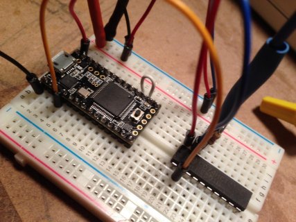

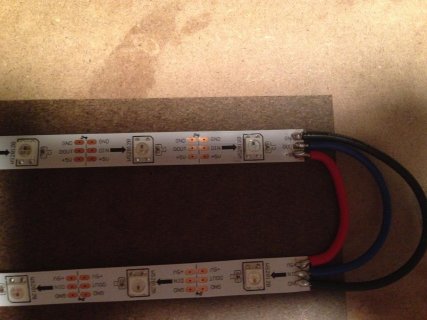

Hello,
I have begun working on a project using the Octows2811 Library and Adafruit Neopixels . I'm a noob with leds but not basic circuitry, as far as I can tell I followed Paul's instructions for the Octows2811 Library. I was testing my strip out with BasicTest sketch, setting only the ledsPerStrip = 30 but all I get is flickering on the first 15 leds. The 2nd 15 do not light at all. I ruled out power because I get around 5 - 5.19 volts at the end of the strip when the leds are running. I'm using 18awg wire throughout the project except the connections in the breadboard. I have uploaded pictures of the project, can't figure out what I'm doing wrong. Here's a quick video showing the flicker >> http://www.youtube.com/watch?v=-nRXylM7kfI&feature=youtu.be
Any help would be appreciated!!
Thanks!

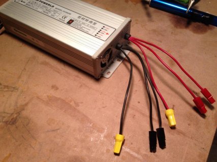

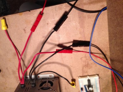

It's best to run the power lines directly from the power supply to the LED strips. Then run the data+ground from Teensy to the LED strips, where the grounds meet at or close to the LEDs.

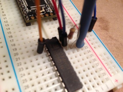

Looks like you're using the 74HCT245, which is very good. Sometimes the series resistor can cause more trouble than it's worth, especially if using ordinary wire (rather than data cable with specific characteristic impedance) that doesn't closely match the resistor. You might try different resistors, or just connect the signal directly to the '245 output, if the wire is short.
Would the series resistor really do much as its placed at the moment? (e.g. it's not in series unless that breadboard is something special)

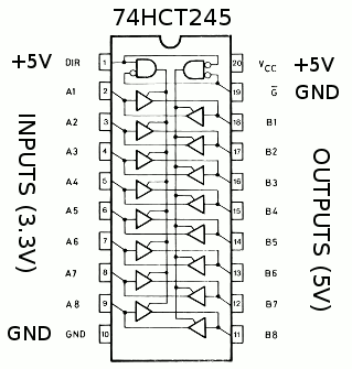

You're missing +5V on the DIR pin of the HCT245 (pin 1). It's also good to ground the GND pin even though you've technically grounded it on the other side @ the OE pin.
Pin 19 is Vcc which is connected to Pin 1 internally, why would I need 5v on the DIR PIN also. I'm getting +5v on the output pins of the 245 with the current placement.
I know it's not pictured but the power lines are going from the supply straight to the LEDs. I do have a question though, I'm going to have 15 x 40 matrix and was going to power them every 4th strip which is 1m. Is that ok? And should I do the same with the GND?

pin 19 is OE, not VCC. You may be getting +5V on the output pins at the moment, but I can assure you that w/o +5V on the DIR pin, you're not going to get anything but noise.
I'm sorry PIN 20 is VCC which is connected to +5v.
Do I connect 5v to both?
Never mind , I'm going to try +5v on pin 1 and GND On pin 10 when I get home. I think that's what you mean.
+5V to pins 1 and 20
GND to pins 10 and 19
On the OctoWS2811 library page, Paul was kind enough to annotate a diagram of the 74HCT245 to indicate where you'll need +5 and GND. It's wired up as a unidirectional buffer:

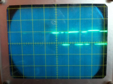

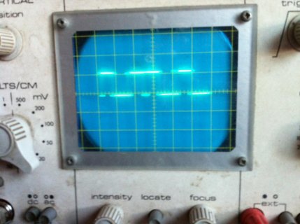

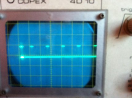

OctoWS2811 Oscilloscope output
Oscilloscope output images: So, I checked the 3.0 and 3.1 signal on my 'very' old oscilloscope. the signal is very different, both same setup and rig, both running basic test:
Teensy3.0:
teensy3.1:
