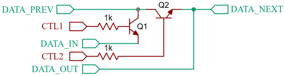

I'm trying to build a modular system where modules that contain shift registers can connect to a bus board. To avoid hard-coding the number and positions of these modules on the bus board (there are sixteen sockets where modules can connect, through IDC connectors), I'm trying to detect them, and route the MISO and MOSI signals accordingly.
For example, if a module is connected to a socket, the MISO and MOSI signals will be routed to the respective IDC so they arrive at the module. The serial output of the module will go back to the IDC and further onto the bus board. If no module is connected to a socket, the socket is bypassed, and the MISO and MOSI signals are routed further down the bus board, to the next socket.
To do this, I'm using transistors that determine where the MISO and MOSI signals should go, for every socket. In the first 12 positions or so, this seems to be working fine, but close to the last positions, there is a lot of noise coming in. The traces on the bus board are 0.25mm wide, and the sockets are placed at 25mm from one another.
Could it be that the latch and clock signals are causing this, due to long distances? Is it OK to pass MISO and MOSI signals through several transistors?
I don't care to have a high speed with SPI, so I've tried slowing it down, but it doesn't help. Any tips on why this is not working and how I should solve this problem?
My goal is to build a plug-and-play bus board with generic code that should be loaded once to the Teensy.

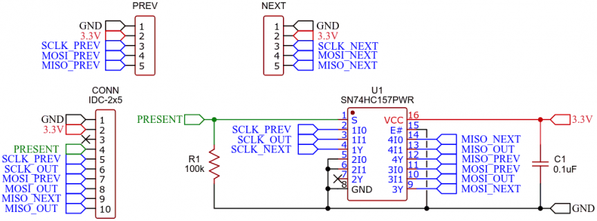

The next simplest solution would be to use a single SN74HC157 chip per socket:
The SN74HC157 is a quad 2:1 multiplexer or selector. One of the four channels is not needed here, so the second channel above has both inputs connected to ground. (The output is not connected. You could connect 2I0 or 2I1 to VCC, and 2Y to the microcontroller to indicate whether this particular socket is present or not. It will reflect the actual state.)
Note that in your own circuit, you can choose whatever order for the four multiplexers. Just remember the signal direction for MISO is reversed, so it needs to be handled in the "opposite direction" (wrt. "previous" - module - "next"), as above.
Whenever pin 1 (S) is low, the _OUT signals on the connector are ignored, and we get SCLK_PREV→SCLK_NEXT, MOSI_PREV→MOSI_NEXT, MISO_PREV←MISO_NEXT, thus bypassing the socket. This is the case when the connector is unpopulated or unconnected.
Whenever pin 1 (S) is high, we get SCLK_PREV→module→SCLK_OUT→SCLK_NEXT, MOSI_PREV→module→MOSI_OUT→MOSI_NEXT, and MISO_PREV←MISO_OUT←module←MISO_NEXT.
Note that all three signals, SCLK, MOSI and MISO, are always routed over each chip, so that the signal delays should stay same. Using a single common SCLK will lead to problems, because there is a 100ns or so propagation delay over each chip. (The difference between MOSI and MISO is that the latter has the opposite signal propagation direction.)
You could add an ON-ON toggle switch between the two PRESENT net labels, so that the user can physically control whether a connected module is enabled or not, instead of yanking on the IDC connector.
You can use the unused multiplexer (2I0/2I1→2Y), connecting 2Y to a microcontroller input pin, and 2I0 and 2I1 to VCC and GND, to detect whether the module is present (and enabled) or not.
You can use R1 and the connector PRESENT pin, connected to a microcontroller input pin, to detect the presence of each module; and connect the 74HC157 PRESENT (S, pin 1) only to a microcontroller output pin, if you want to enable or disable each module present via the microcontroller.

Still no idea what the problem with the transistor circuit is as you haven't provided the schematic...

I do suspect the issues alexandros is seeing are due to timing mismatch between clock and data signals, as well as noise. Schmitt triggers on input can help with the noise, but to fix the timing issues, both clock and data signals must be routed the same way (with roughly the same length conductors). Where the limits lie for "same" depend on the data rate, and allowed rise/fall times.
Note that for '595, the latch signal does not need to be synchronized with the clock at all: a rising edge on the STCP line latches the output pin states from the internal shift register. (A new bit is read into the internal shift register from the DS pin on the rising edge on the SHCP line, and on the falling edge the Q7S will change to the value of the highest/oldest bit in the shift register.) You can simply wait for the maximum duration of combined latencies after the last falling edge of the SHCP line (so that even the last module will have seen the last falling edge of the SHCP line), and then pulse STCP high for at least 110 ns.

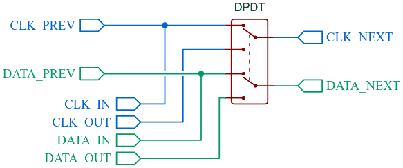

In a very real sense, a SPI bus can be modeled as a pair of shift registers, one in each direction, with a common clock. There is no need to bit-bang the bus, as you can use just one side (MOSI or MISO) of a SPI peripheral; I would consider using two SPI buses here, if both directions are needed.
If we look at just one direction, a simple two-pole two-throw switch (6 pins) is needed per module:
Note that the above corresponds to SPI SCK and MOSI, and if you add MISO, it is reversed wrt. NEXT and PREV signals (with _IN being the actual input to the module, and _OUT the output from the module), and of course a 3PDT switch (9 pins) is needed.

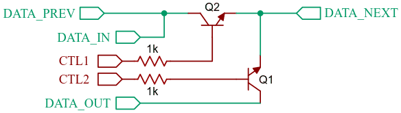

As I understand it, the Boolean logic needed for NEXT is NEXT = (PREV AND (NOT PRESENT)) OR (OUT AND PRESENT), where PRESENT is asserted when a module is present. (XOR can be used instead of OR, too.) If I read it correctly, the circuit implements the above via
where CTL1 = NOT CTL2. The problem here is that a module present cannot be turned off, because it directly drives the data line to the next module. I was expecting something along the lines of
instead, with CTL1 = NOT CTL2 strictly enforced.

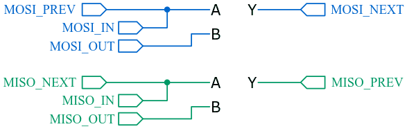

My suggestion is to use SN74HC157 instead:
with clock routed exactly the same as MOSI, assuming PREV is toward master, and NEXT is away from master, and module N's NEXT is module N+1's PREV. On the 74HC157, /G is always low, and A/B is high when the module is in the SPI chain, low when the module is bypassed or not present. You do need a 100 nF = 0.1 µF ceramic capacitor near each '157, between VCC and GND.
Now, because the '157 has four A/B/Y switches in each package, you could use a separate clock for MOSI and MISO, essentially making them separate shift registers in opposite directions. Or, you could have a SPI bus with two signals in one direction, either MOSI1+MOSI2+MISO+CLK or MOSI+MISO1+MISO2+CLK. Note that you then also need half the selector lines; only one per socket (A/B to '157).
The SN74HCS157 (SN74HCS157DR in SOIC-16 and SN74HCS157PWR in TSSOP-16 are 0.38€ or less apiece at Mouser) includes Schmitt trigger inputs, which should add some noise immunity. Adding small-valued resistors in series with the signals can also help, because that way more current is needed to pull a signal high.
I almost always have to iterate my own designs and boards; this (74HCS157 per IDC socket) would be the way I would continue here, considering the observed issues and complexity. I do not know how one could fix the existing board without basically a complete redesign. That is also why I don't see any sense in examining the code that would only work with the current board design; apologies. :cry:

Thanks for the detailed answer and ideas! The SN74HC157 seems like a great solution. Also, I didn't think of routing the clock signal the same way as I did with the data signal, which makes total sense as you point out. The MOSI+MISO1+MISO2+CLK scenario is what I need here. I guess I can use the hardware SPI clock pin (13) with another SPI bus, or with software SPI (with shiftIn()), right? This software SPI will run once when the system is powered up, and then the hardware SPI will take over, so there shouldn't be any conflict with the pins used.
A redesign is indeed what's needed here. It will take time, but I'll get back with results when I have designed and printed a new board.
