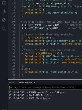

I'd like to use the onboard W25Q128JV-DTR for storing user settings + data, but the chip just... never initializes, with the code hanging on FS object's "begin()" method.
I'm unable to get any LittleFS example running using either QSPIFlash or QSPINAND objects.
Not even this sample code runs (source). It hangs on "myfs_NOR.begin()"

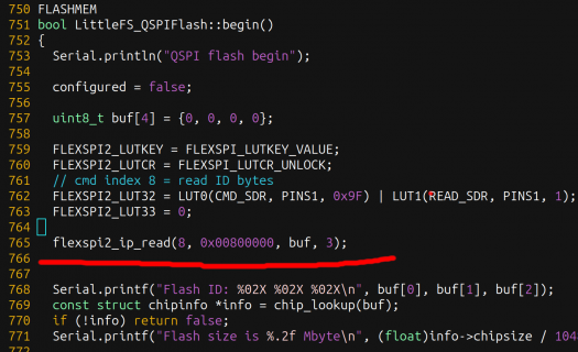

I took a look at LittleFS.cpp and uncommented all of the existing Serial.println() statements in LittleFS_QSPIFlash::begin() and found the code is hanging at line 765: "flexspi2_ip_read(8, 0x00800000, buf, 3)"
Not sure where to go from there...
