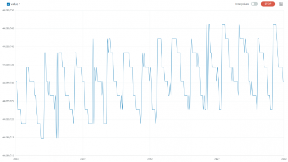

Hi, I finally also gave it try and implemented a multichannel version of the usb in- and output. Escpecially the usb input seems to work on my Windows 11 notebook nicely, but I would be glad if somebody else could also test my implementation. If somebody is interested, the code can be found here: https://github.com/alex6679/teensy-4-usbAudio/tree/main
I have to admit, my focus was on the usb input and I spent quite some effort on improving the computation of the feedback to the host. At the usb output I did not change that much. The only mechanism that prevents buffer over- and underruns here, is the duplication or the skipping of single samples. On my notebook for example the output duplicates a sample every 5-6 seconds in order to prevent a buffer underrun. I know, that is not the best solution, but maybe a slight improvement over the current implementation.
Also, I switched the USB standard from 1 to 2. I guess in hindsight this was probably not necessary.
I am curiuos about your experiences with my implementation.
Since I found some time, I want to describe my changes to the usb input, especiall how I changed the feedback:
- I don't only use the raw number of samples that are currently stored in the buffer for the feedback computation. Instead I also measure the time of the last packet of samples that received and use the rate at which the host sends samples to the Teensy. E.g at 44.1khz and when the last packet of samples arrived 0.5ms ago, I add 44.1kHz*0.5ms = 22.05 virtual samples to the buffer count. (As if the samples arrive sample by sample and not in packets) This value does not depend that much on the short term timing of the isrs and therefore I think it is better suited for the computation of the feedback.
- If I understand the current code correctly, at the moment the controller for the feedback is a pure integral controller. I use a PI controller and added the proportional part, so that deviations from the target number of buffer samples are faster corrected. The parameters of the PI controller can optionally be set in the constructor of the usb input. However, with my notebook they did not seem to be that critical and I hope that the default values work for many hosts.
- When an audio stream starts, or if there really is a buffer under- or overrun, the buffer is resetted and the number of buffered samples is set to the target number (filled with zeros). Hence, the controller starts a the optimum value and does not need to recover the buffer from e.g. a near underrun that just happened by chance at the beginning of a stream.
- Not related to the feedback, but maybe noteworthy: The bInterval is set depending on the number of channels, sampling rate and sample bith depth so that the usb packets do not exceed 1024 bytes.
Here an example plot of the buffered number of samples (the number of samples was plotted every 200ms). The blue line shows the actual samples and the orange line the acutal samples + the virtual samples. The stream just started and the PC sends the samples a little bit too fast to the Teensy.
After a while the number of buffered samples settles close to the target value of 79.3 samples:
I let that test run for quite a while, and it seemed that the buffered samples remain just very close to the target value, without anything ineresting happening.
Unfortunately, I only have a Windows 11 notebook and can't test how the input works with other hosts.
