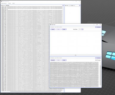

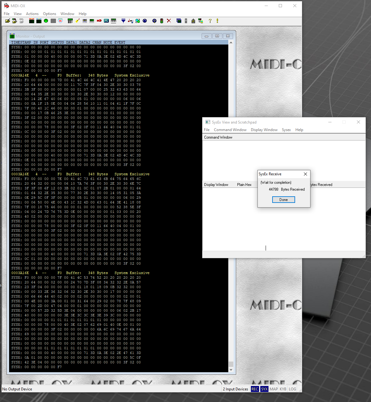

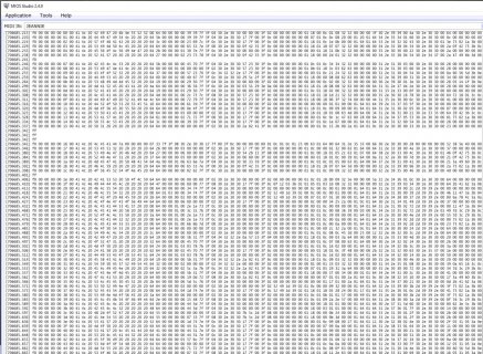

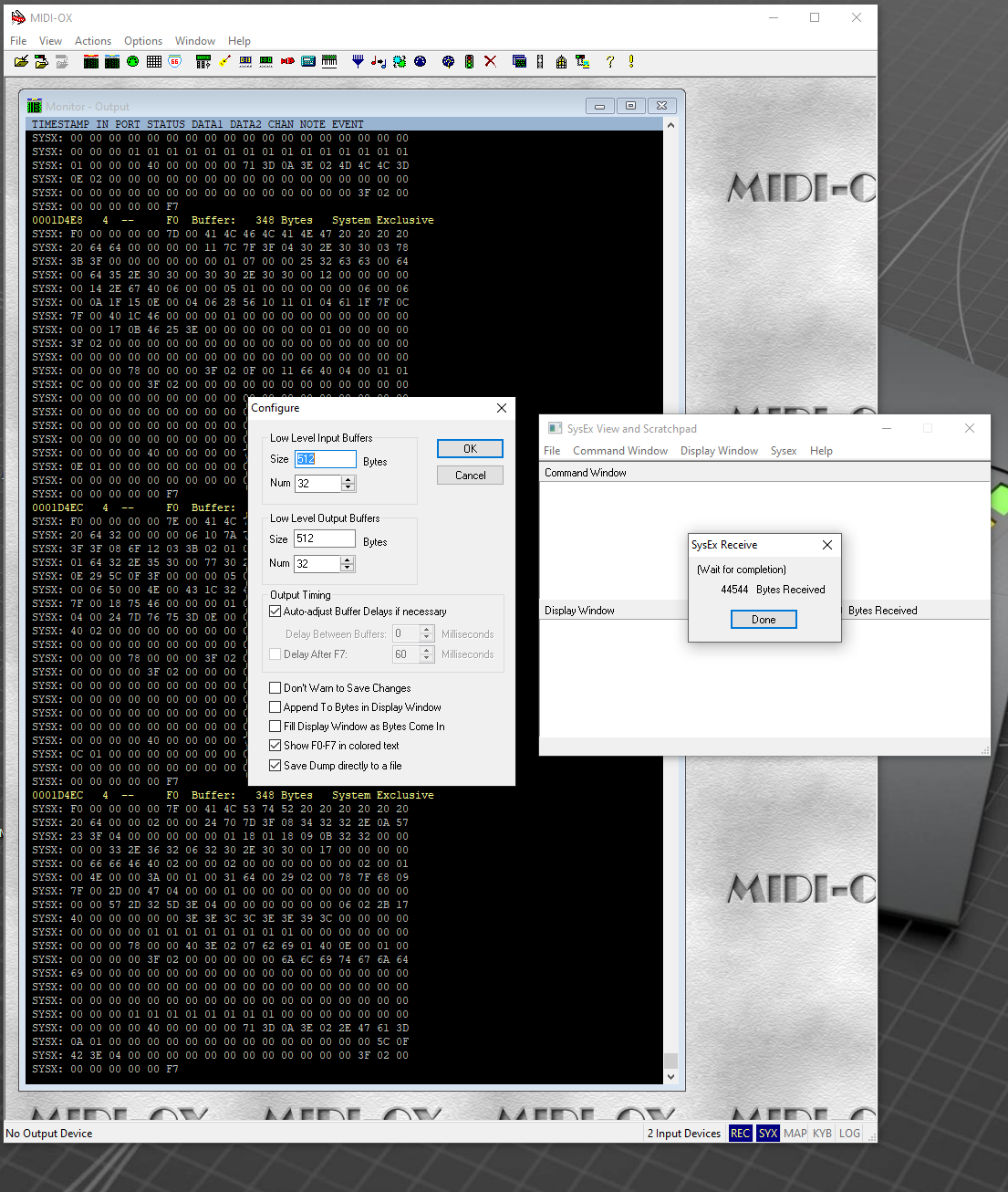

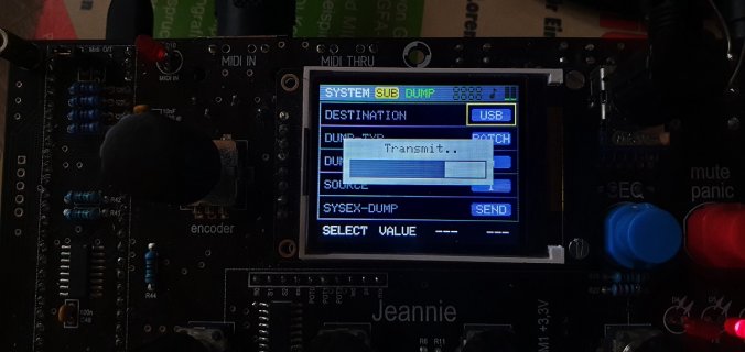

Hello teensy friends
I programmed a midi dump function for my Synthesizer with Teensy 4.1. Transmission errors occur when I send Patch Bank data to the PC via usbMIDI.sendSysEx. The data packet is 128 * 348 bytes in size.
I have added long waiting times after 348 bytes to avoid transmission errors. But I'm not sure if this is the right way.
Thanks for help :)

Wow, That's huge. Fourth line looks truncated after F0. Seen similar truncations if some data miscalculation tries to send a value >127, not the case here as the four byte header (zeros) was supposed to come next.
My hunch is buffer overrun.
Tranfer only one patch, it no error.
To protect against Buffer overflow, I made a wait time 120ms after sending each patch.
Is there a way to query a faulty USB transfer :confused:
Largest sysex dump here 4 x 140 bytes. Did need delay but used non-blocking type. What about a ring buffer?
After transferring a patch (348 bytes) I wait 120ms. From time to time there are transmission errors.
If you post a sketch here that dumps that sysex in response to serial monitor keypress am happy to test on Windows with Midiox.
Now.. I have implemented USB and Midi SysEx transmission. USB often has transmission errors. Midi works without error :)
a lot of sysex data..

A patch bank is now transferred error-free via USB in less than 2 seconds :)
Via Midi it takes about 15 seconds.
Moderator Edit: some info in this message is technically incorrect. Please see msg #88 for detail.
As I understand it, the usb_midi_flush_output() function is responsible for deleting unread data in the midi buffer.
Since I am constantly querying the Midi buffer in my Polyphonic DIY Synthesizer with MIDI.read() and usbMIDI.read, there should be no disadvantages if this function is switched off.
On github I will then point out the changes in the Arduino Library and the changed usb.c File.
But my thoughts are still buzzing, why are there transmission errors via USB Midi? :confused:

I use Mios Studio without problems. When I use MIDI-OX I have the same problems.
In MIDI-OX I discovered an error when receiving SysEx Dump. The number of received SysEx data is displayed incorrectly in the preview window of the SysEx Dump function.
Instead of 44,544 bytes, I see 44,766 bytes. In the large main window, however, the number of bytes is correct.
However, if the SysEx dump data is saved directly to a file (Sysex Configure > tick "Save Dump directly to file"), no errors occur.
The number of data received matches the data to be sent.
