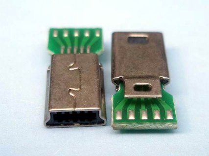

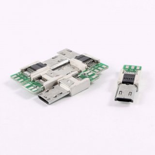

* Use a bare wire micro-USB extender with the Teensy jack (hard to find and/or expensive)
* Remove the Teensy USB jack and solder wires to the pads (unworkable)
* Use the test pads on the bottom of the board when mounting to the main PCB (work intensive)
* Make a custom PCB "mate" that plugs in to the micro USB jack and then exposes pins down to the main PCB for soldering (extravagant, but most workable into production)
Any suggestions or comments?
