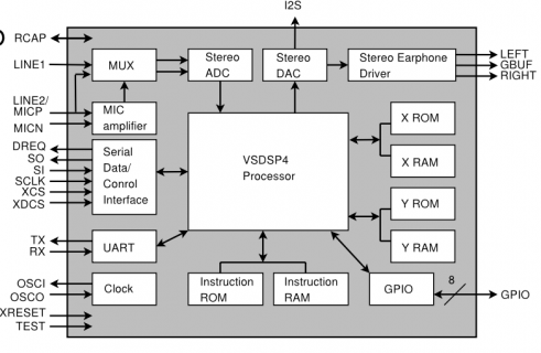

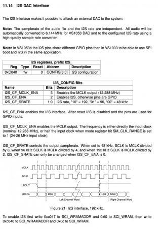

Does the VS1053 support being an I2S slave? With I2S only one device can be a master (generate the clocks).
I think it may generate the clock based on this page
from the this data sheet (linked).
That makes the VS1053 an I2S Master, right, and hence I2S would not work for the yellow path below?

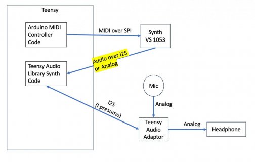

This is the flow I want:
- Audio can get from the microphone to the Teensy Synth Code
- Audio can get from the VS1053 Synth to the Teensy Synth Code
- Synthed or modified audio can get from Teensy Synth Code to Headphones
  • VS1053 - I2S Section.pdf
I would look at integrating this chip on I2S2 of the Teensy. Then it can run as a master (or slave), and the audio shield will work just fine on its intended I2S1 ports. Each SAI (I2S + I2S2) can run independently. I do this with the ESP32 running as a master.
Thanks, Jay.
So, I'd connect the VS1053's I2S out to the secondary I2S2 input of the Teensy.

The VS1053 has two kinds of output I2S (as Master) and analog, which I have used for a headphone jack (and has kind of wimpy output).
If I were to instead take the analog output of the the VS1053 and pipe it into the Teensy 4x
How would I connect the three pins (Right, Left, GBUF)?
The VS1053 data sheet say GBUF is a "Common buffer for headphones, do NOT connect to ground!"
"GBUF must NOT be connected to ground under any circumstances.
If GBUF is not used, LEFT and RIGHT must be provided with coupling capacitors.
To keep GBUF stable, you should always have the resistor and capacitor even when GBUF is not used. See application notes for details."
The GBUF is a different ground (at DC) so I wouldn't connect it. Left and Right are floating relative to GBUF so would need to be AC-coupled. I fear this would work but would have low performance as Left and Right are not relative to ordinary ground and you cannot assume GBUF is the same AC ground as GND, if you see what I mean.
Internally GBUF is an amplified output so you must never short it to anything (at AC or DC). Its exists to avoid the need for large electrolytic capacitors when driving headphones as the chip is designed for use in small devices, just like the SGTL5000
That work is clear enough to test the I2S path, though on the Teensy 4.0, I'd need to use one to the back pads (33) and also find the Audio library extension that allows I2s2 to be a slave.

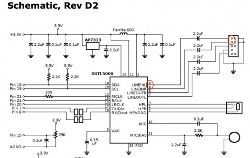

Is there an audio engineer-type Teensy person on the forum that I could hire for a little coaching?
In particular, connecting the VS1053's LEFT and RIGHT Stereo Earphone Driver outputs to Audio Board's LINEINL and LINEINR header as in this drawing:
- will this work?
- what else will I need? (I note the Audio board already has caps on these two inputs)
...and of possible significance, I'm also interested to use the MIC input as a separate signal.
- any problems there?
Thanks

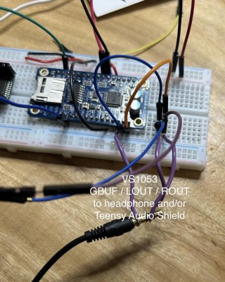

I have the Adafruit board and I can use its example sketch to play a MIDI sequence out the LOUT and ROUT pins (along with GBUF) to a pair or headphones.
I'm trying now to connect the VS1053's ROUT and LOUT pins to the Teensy Audio Board's LINEINL and LINEINR.
My immediate plan is to use the Adafruit example code to produce the audio, and use the Teensy Audio to route it to the headphone jack on the Teensy Audio board.

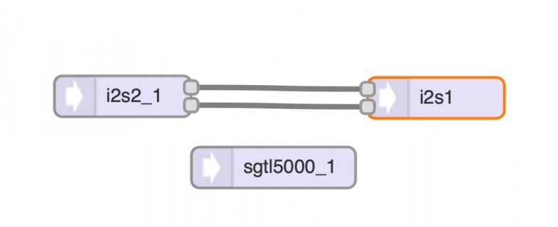

I'm looking at the Audio GUI tool to try to get that's right.
Is this going to do it?
Just got it wired up with code that should work, but no evidence of the audio from the VS1053 getting out to the Audio Shield's earphones.
Could I contact you via direct message?
Start with an example. Probably audio passthrough example or USB passthrough. This will probably give you examples about enabling the io on the codec...
The USB passthrough example will let you control the volume with the PC volume slider which might be helpful...
You'll need to configure the input on your sketch. https://www.pjrc.com/teensy/gui/?info=AudioControlSGTL5000#

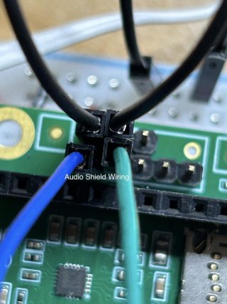

And here's the hook-up:
The wire color changes from Blue&Green to blue&purple between the AudioShield and the VS1053
