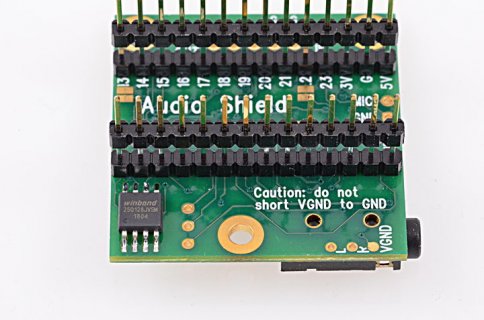

I went to buy a W25Q128FV as prescribed for the Audio Shield and found that it's no longer available. DigiKey says this is a direct replacement:
https://www.digikey.com/product-detail/en/winbond-electronics/W25Q128JVSIM/W25Q128JVSIM-ND/6819721

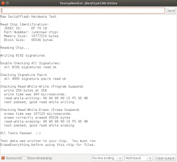

However, I've got it soldered to the shield and the Raw SerialFlash Hardware Test is saying
Read Chip Identification:
JEDEC ID: 0 0 0
Part Nummber: (unknown chip)
Memory Size: 0 bytes
Test failed
If it helps shed any light, SerialFlash.begin(FlashChipSelect) returns true...
I know that SerialFlash automatically detects chip types, and this new version of the W25Q isn't on the list so could that be the source of the problem? I did a good soldering job and the chip is oriented as shown in pictures so I'm pretty confident it's all hooked up correctly.
Thanks for any help!
