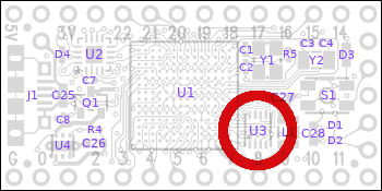

4 blinks means something is wrong with the flash memory chip.

To start troubleshooting, first get a DC voltmeter. Measure the voltage between VIN and GND. It should be 5 volts, from USB. Next measure the voltage from 3.3V to GND. If Teensy powered up, it should be 3.3V.
If your Teensy is powered up, try holding the pushbutton for 15 seconds. At 13 seconds it should give you a quick blink on the red LED (near USB) to indicate the beginning of the 4 second window where releasing the button initiates a full wipe and restore of the flash memory. Let the button go when you see that. The red LED is supposed to turn on bright for quite some time as it slowly wipes the flash. On Teensy 4.0 is usually takes about 45 seconds. Let it finish. If the process works, when the red LED turns off Teensy will reboot and it will be running the LED blink program again, which blinks the orange LED.
As for what went wrong, almost impossible to guess from only this info. Just a defective board doesn't make sense if 2 have failed. Likewise for ESD, unless you have a really horrible environment (you would know as your body would feel shocks regularly when touching things) two failed seems pretty unlikely.
All sorts of "software" things can go wrong. If it's not actual damage to the hardware, that 15 second button press should always recover.
