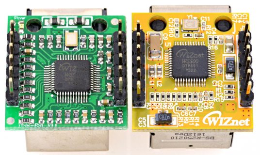

Cheap clones have also appeared on Ebay and Aliexpress. For example:
http://www.ebay.com/itm/USR-ES1-ENC...thernet-Converter-TCP-IP-Module-/201560299414
Even though this item's description says "USR-ES1 ENC28J60 W5500 Chip SPI", it is indeed the Wiznet W5500 chip and does not actually have the Microchip ENC28J20 chip.
From the top side, the clone looks virtually identical to the Wiznet WIZ850io, except for the PCB color and different marking on the RJ45 connector. But if you look at the bottom side, it's definitely not the same PCB design.
(click for full size)
I have personally tested both boards shown in this photo. Both work fine. I also retested a WIZ820io and WIZ812MJ with the latest library running on Teensy 3.6. All of them work now.
