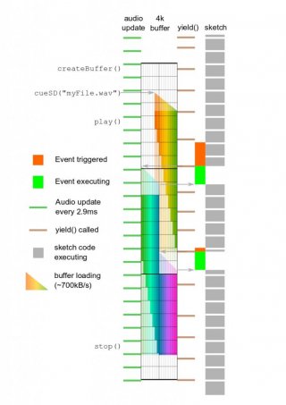

Technical stuff
The absolutely key function, which is dissimilar to the ancestral AudioPlaySdWav object, is createBuffer(). If you don't call this for every object then you'll almost certainly get poor results! It allocates buffer memory to allow filesystem reads to be a sensible size. This not only reduces the read frequency (and hence CPU overhead), but also means that if there is the occasional delay there is some chance the buffers will have enough data that the audio won't glitch. The buffer can be allocated either in heap or in PSRAM; the latter doesn't have as much impact as you might think, because transfers between SD and PSRAM seem to be about as fast as between SD and fast RAM. For the above test I allocated 64k for each playback buffer, and 128k for each record buffer, using a total of 1.25MB of the 8MB PSRAM.
The other thing to be aware of is that filesystem transfers happen outside the audio interrupt updates, within the context of your application: this is done using the EventResponder library, which means that your application must call yield() reliably often. You can do this by allowing loop() to exit, or by explicitly calling yield() in your application, or by using delay() (if you must...). There may be other library calls which yield(), but I wouldn't want to rely on them myself. "Reliably often" is hard to quantify, but the bigger your buffers the less often you need to do it. Buffer refills trigger when they're half empty, so a 64k buffer will be refilled when it gets below 32k; if you're using it for a mono WAV file that will be every 371ms; with 16 files playing, a refill will be needed on average every 23ms. I have made some effort to ensure buffer refills are staggered in time, so there's a fighting chance your application won't stutter because 16 reads taking 5ms each have all triggered at once.
For playback the buffers are pre-loaded when the playSD() function is called; because this can take some time, if synchronous starting of multiple files is important, you may wish to use cueSD() to prepare them all, followed by play() to set them going.
