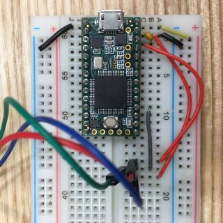

USB noise in ADC readings?
I am working on a project to collect scientific data from sensors via the ADC, at high sample rates (right now at about 150-160ksps). The data is not being stored on the Teensy, but is being piped into a linux computer for a variety of processing and machine learning tasks. The Teensy is basically a buffer right now though we might do a few more things in the future.
Everything seems to be working well but transmitting the data over USB seems to be producing noise in the readings. The sensors are still under development so right now I am using an adafruit microphone to test. Sample buffers are sent over USB once they are full and the rate at which they get sent matched perfectly with the frequency of the noise I see in the data (when I adjust sample rate or buffer size).
Circuit & Noise:
I am using platformIO with makefiles (Clion), and the arduino framework. Only using the ADC library right now. Code attached. Any advice or help would be great :)

You should always shield analogue signal wires. Also decouple the microphone VCC to GND at the device
Buff0/1 should be volatile as your interrupt changes them
If you want high speed I'd trigger a DMA to transfer the ADC0 output into a circular buffer and interrupt on complete. You could use two in a ping pong configuration
Scratch that just DMA your ADC data directly into the USB Serial FIFO. Trigger it off ADC complete
I'm not sure if Serial.print() triggers an interrupt but it might be worth setting ADC0_ISR to have the highest priority. What frequency is that noise?
Try using the CODE tags so people don't need to download files
Just my two cents but normally for double buffering the pointers are swapped in the main loop(). This reduces the processing done in the ISR() routine and allows you to instinctively know which buffer to use as front[] will always be the complete buffer and back[] will always be the one being updated
Also welcome to the forum ;)
EDIT -
Why are you buffering your data before transmission? Is USB serial too slow for you?
The USB buffer is 64bytes large so if you try to write more than that Serial.print() will block until the buffer is sent. Reading on the topic over here
Everything up to the ADC pins is being designed by another student and it is very nice and shielded. The sensor we are working with now is a hydrophone to record echolocation clicks, but they want it designed very generically so it can be used for other bio-acoustic projects. The other student is still getting the analog board built so that is why I am testing with the adafruit mic. The noise seems to be white noise from 0-20kHz, but the frequency of its occurrence is 18Hz, which matches exactly with what one would expect given the current sample rate and buffer size is cross-talk from the USB is the source. I scoped the microphone signal and the 18Hz noise isn't present.
Thanks for the advice on the code as well :) this is my first time using a processor with DMA so I had planned on using that in the my next iteration but I am still researching all the details on how to implement it. putting it straight into the USB FIFO sounds awesome, I will have to look into that. The major thing limiting my sample rate right now is the Serial.write() call which seems to block for 2.5us (i think). if the adc interrupt collides with a USB write everything just stops.
I will put the code inline next time, just thought it was kind of long :)
The USB writes seem to take 2.5us no matter how big a buffer i send it. I don't think I ever tried just sending it exactly 64bytes before, I will experiment with that.
Does it help to put the green/signal wire directly to pin 16? That takes out a piece of breadboard between the +/- power, one connection, and that black jumper wire.
The pic looks like AGND is wired to "+" on breadboard? is the Teensy shifted up one?

AGND is wired to GND (redundant i think), Vin is 4.5V, 3.3V goes to the mic, and AGND to the mic as well. there is a .1uf cap between AGND and 3.3V since there was a small ripple in the teensy voltage when I was troubleshooting this bigger problem. Just tried hooking the mic right into pin 16, didn't help :(
AGND and GND are separated by a inductive noise choke on the Teensy board, so I would think they should NOT be connected, to keep the mic AGND away from the digital noise on GND

Getting good low-noise analog signals into any digital system (including a Teensy board) can be a challenge. The cleanest systems use a separate PCB with the ADC isolated from everything else, and careful attention paid to where the ground currents flow. Remember what you call "Ground" is not 0 volts everywhere, if there is any current flowing through the system you always have the I*R voltage difference.
The first thing to try is to make a single-point ground, iin other words all your external circuits return to ground at the very same pin. Also, having your ADC Vref the same 3.3V as your processor supply power is not good practice for stable low-noise ADC operation due to the voltage noise on the power bus as the processor current spikes and fluctuates with time.
If your values are less than 1.2V high then maybe you could use the internal reference, that should be more isolated.
Or even an external reference that is isolated from the USB power somehow.

Again I will mention the requirement for shielded cables from the microphone to the device. You should also put a decoupling capacitor on the microphone power supply itself on the same PCB as it. Many recommend putting a inductor in series with the power supply to isolate the high frequency digital signal from the analogue circuit. This is effectively already done on the Teensy schematic. Do yourself a favour and if you have a decent oscilloscope attach one probe to AREF and see if there are any fluctuations

Is any part of the system (besides Teensy) getting external power? If so, you might have a ground loop, where ground current unexpectedly flows through sensitive ground paths and ends up creating a false signal. Usually the quick way to test involves running various parts from completely isolated batteries, to completely eliminate the possibility of unexpected ground currents. If it's quiet with (impractical) batteries running all parts, then at least you know what the problem is when you try to find a more practical solution.

I had a MCP3008 breakout laying around so I am going to integrate that today and see if that solves the problem. If so I may just move to an external ADC that meets our requirements and just use the teensy as an SPI FIFO for now.
Paul: I am already re-wired for the external ADC but I will whip up some battery packs and try that out, thanks for the advice. In the final deployed configuration there is only one battery pack though. I will talk to the EE about it, see what he thinks. I am just curious at this point, and it would certainly be nice to keep the BOM down if I didn't need an external ADC.

I'd strongly recommend cutting the VUSB line on the Teensy and giving the Teensy it's own power supply isolated from the PC. Since the issues occur during USB transfers it makes sense to look there. I've had a lot of issues with connections to the PC causing noise. Optocouplers anyone?
Have you tried analogReference(INTERNAL)? I think this would help a lot
