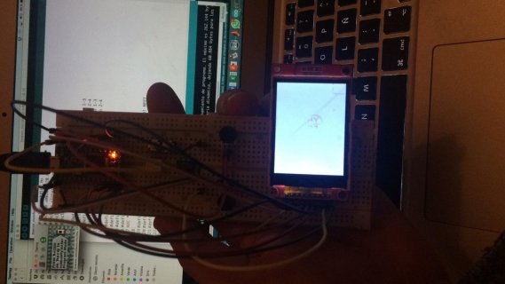

CURRENT WIRING
according with the info I can use pins 13 or 14 as SCK pin. I am using pin13 for other task however I changed pin 13-14 for the SCK and it doesn't work yet.
I don't know what is going wrong here.
I was able to make it work with two minor changes. PIN_SDI should be pin 11 and PIN_SDO should be pin 12.
Good luck.
i changed the defines
#define PIN_SDI 11
#define PIN_SDO 12
and the wiring, after these changes the whole code is running but on the display I can't see anything.
I corrected an error but another left.

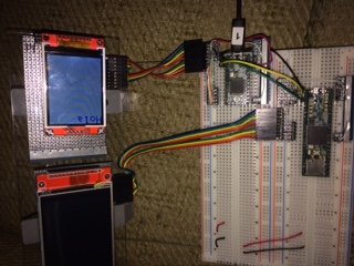

I am not sure of why it is not working for you. My LCD is wired per the pinout in this link: https://www.pjrc.com/store/display_ili9341.html
Here is the your code that I changed and it is working for me. There was a minor error in the call to the display where I had to remove a space between the P and IN_SDO so it is now PIN_SDO.

Hope this helps. If this does not work for you, I would suggest you verify your wiring connections are the same as shown in the wiring diagram in the link above.
I rewire the display the same as in the link and I have the same problem.... I couldn't see anything....
May the screen be damaged? How can I check if the screen is ok?
My best suggestion is to test the code using a different display. This is why I have one display like this and two of the newer displays with the touch screen. If you do not have another display, then I am not sure of how to test to see if the display is OK.
Sorry you are not getting this to work.

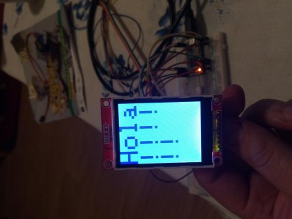

finally I restarted all and the display started to work!!!
Only one more question... If I want to change the text between horizontal/vertical, what have I to do?
Thanks for the help.

Glad you got it working. I really like this display and I am now using the touch version as my standard display.
Use the setRotation(value) command with the value being 0, 1, 2, or 3. Each value will rotate the text by 90 degrees.
tft.setRotation(3);
Have fun!
