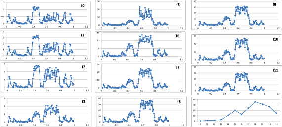

UPDATE: I ran two additional tests tonight to check out the actual raw data I am getting with the existing setup. Actually pretty happy with the results but still sorting through the differences between the HB100 backpack that I got from tindie vs your design. Anyway, in this first test I am first moving my hand back and forth across the horn and then towards and away and back again. I wind up with two peaks as expected the first at around 0.45 seconds and the second at 0.7 seconds (mid points). Guess the speed of my hand movements would be between 3.4-3.8 mph across and around 3 mph back and forth?
The second test is me getting up from my desk and walking to the front of the house and the walking back and sitting down. Both directions the speed seems to be around 3 mph or so, I think.
Is this analysis about right?

Was looking at the data a little more now that I am not asleep and running a few more tests and no matter how slow or fast I move my hand in front of the sensor I always seem to get the max bin at f8 and when moving slowly I will see large peaks but a bit smaller at the lower frequencies (f1 or f2). In looking at the code I was wondering if you could explain the bin ranges for fft that used, read(9,13) etc as well as the addition multiplication factors you are using for each level:

EDIT: in looking at the equations some more, assuming I am doing the calcs right, each freq bin is 10.25 (43/4). I think this would imply that for level 8 you frequency range is (40-23+1) = 18 * 10.75 = 193.5hz or 247.25 to 442.75 hz. The power that you list for level 8, I would think should that be the average power over the entire range centered at 344 hz since the read is the sum over the specified range. Please let me know if this is correct?
I went ahead and implement my perception of the fft in the previous post with the following results: 1) peak frequency at 43 hz which I think equates to about 1.35 mph. I am attaching the charts for reference. Peaks are definitely not as pronounced but that may be because of the basic horn I am using. Here is the code if you want to give it a try:

EDIT 10/31: I made one more change. I changed the window to a Blackman Harris and here is a shot of me walking away and coming back
the first three peaks at 21.5 is me moving my hands on the mouse in front of the horn. The next two peaks is me walking away and coming back at 43 hz. Then again at the end you see the 21.5 hz line increasing, that the mouse moves again. Ok that's it until I figure out what I want to do with horn - a new one or play with this one some more :)
