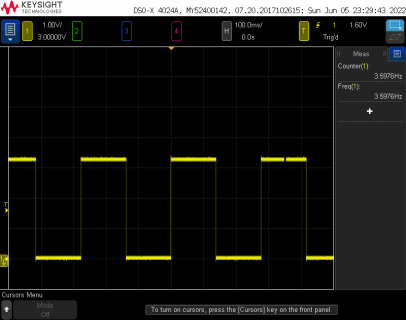

When Teensy 3.6 runs at 180 MHz, my oscilloscope sees the pin oscillating at 3.5976 Hz. It remains constant, same before and after the EEPROM write on the 3rd time loop() runs.

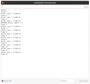

Here's the result I see in the Arduino serial monitor.
Maybe you could try running this test program on your Teensy 3.6?
I can't say what's going wrong with your display refresh rate. But I'm pretty sure the cause isn't Teensy remaining at the slower speed used temporarily while writing to the EEPROM (on-chip FlexNVM hardware).

Paul: Thanks for looking at this. From your test code, I see the same number before and after the write at 120 through 180 Mhz compiles.
