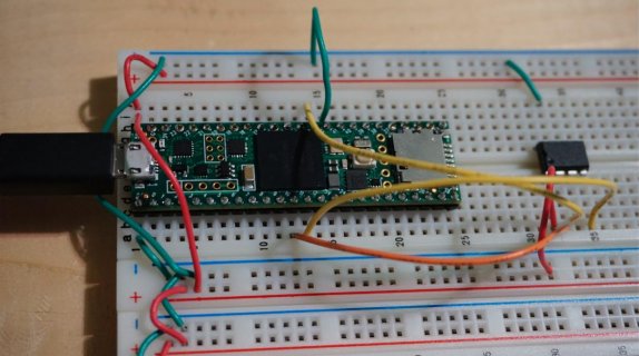

Hi ! Trying to make a midi to cv with my teensy 4.1 with a MPC4822 DAC.
From now, I believe the teensy receive the messages but the outputs of the 4822 are only +- 0.5v at maximum and doesnt really follow my automations.
I feed the Dac with the 5v of the teensy.
Board set to midix4, 600mhz, fastest.
Here's my code :

As a first troubleshooting step, I'd recommend printing to the Arduino Serial Monitor so you can see the actual number before your code tries to send it to the MCP4822.
Something like this:
  // Map the CC value (0-127) to the desired CV range (e.g., 0-4095)
  uint16_t cvValue = map(value, 0, 127, 0, 4095);
  [COLOR="#FF0000"]Serial.println(cvValue);[/COLOR]
Ok so i dont know if this would be the proper way to do it but i add that serial print code in the loop of my code then upload into teensy. After i started Logic with my automation and then open the serial monitor but nothing is shown there.
Does this mean it even receive no cc ? Thanks !
Add this at the end of setup(). Or anywhere in setup()...
  while (!Serial) ; // wait for Arduino Serial Monitor
  Serial.println("Hello World");
This won't fix anything, but it will at least confirm if Serial.println() is really sending to the Arduino Serial Monitor window.
When you see it print Hello World, the next step is to add something like this:
void OnControlChange(unsigned char channel, unsigned char control, unsigned char value)
  [COLOR="#FF0000"]Serial.println("received CC message");[/COLOR]
so you can tell if any CC messages are really arriving. This can tell you if your input circuitry is working. No point messing with the software side if the input circuit is bad.
You can also add printing of their parameters, if that helps to figure why messages you are getting don't give the expected result.
It writes Hello world at the start. Then I add the next code to print cc message in the loop but nothing again !

In Arduino, click File > Examples > Teensy > Serial > EchoBoth. Change the baud rate from 38400 to 31250 and upload.
Optional, add the Hello World stuff, so you can be sure it is really running.
Does it print anything at all while your MIDI messages are incoming? If nothing, then you probably have a hardware issue with the MIDI input circuitry. We can help, but only if we're able to see it. Photos are best...
I understand ! So I did what you said , Hello world appeared ! But yea no midi cc..
On thing is each time i upload, Logic give me a notification that its see the 4 midi i/o so i believe the midi implementation is working ! Well I hope haha
Oh ayaye haha I though because of the Midix4 set up it would communicate ! Thanks for your help! Ill try another one :) Have a good day !
Ok ! So back on track with another take ! Things seems to be going good except that I cannot get the 4822 to deliver 5v at 127 value.
But it follows the automation ( maybe it could be faster but will see that later )

Im about to add an op amp to get the 5v or would it be simpler ( codewise ) to get a 4922/21 ( with a voltage ref ) to achieve the 5v ? Or is there a way to get the 5v with the 4822 just in modifying this code ?
Thanks a lot !

Hi, glad you are making some progress.
In future when you are posting code could you enclose it between CODE tags (can be entered by using the # on the reply form) it makes your code easier to read and help those who might be able to help you.
Quick look at the MCP4822 datasheet says it has an internal 2.048V reference, and you can select either unity gain or 2X gain output. So the output range ought to be 0 to 2.048V or 0 to 4.096V. Does not seem to be any way to get 0 to 5V output. You could add an opamp circuit to amplify the voltage.
If you use a different chip that takes an external reference voltage, check the specs on the DAC and the VREF chip. Often chips need power that at a higher voltage to output their maximum. Most Opamps also have this requirement.
