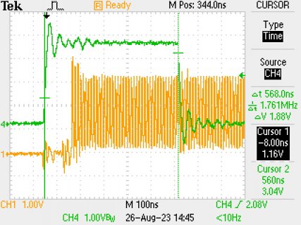

I see the following on the trigger and clock (ext PSRAM in this case)
Zooming in, I count about 40 clocks before the function returns the byte I need. However, I believe QSPI should only need about 14 clocks (2 inst, 6 addr, 4 turn-around, 2 payload) for a single byte, so it appears to be loading at least the full 32 bit value, or more, before returning.

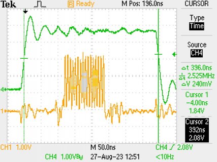

Even using the FlexSPI registers direct and clocking at 132MHz, I get this:
I count 16 PSRAM clocks, which is close to my assumption of 14 for a byte
Still nearly 400nS, which correlates with the CPU clock counts in the other post.
Looks like a good 100nS of waiting around after the transaction though, not sure why FLEXSPI_INTR_IPRXWA doesn't come back a little sooner, also takes some time on the front end.
The transaction itself is <150nS, but the pre/post nearly triples that...

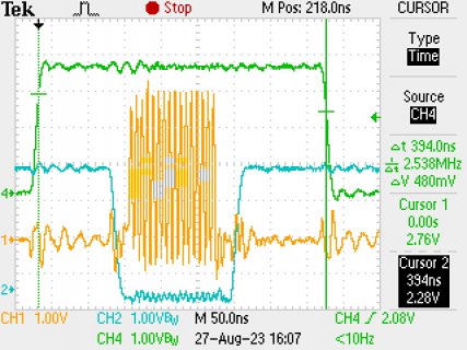

My initial shots didn't include CS, so I added it to these captures along with SCK and the trigger signal.
First, the default case (same as prev msg)
CSINTERVAL=2, TCSH=3, TCSS=3

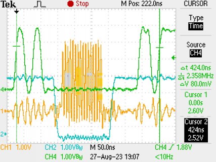

Then, deceased setup/hold to 0:
CSINTERVAL=2, TCSH=0, TCSS=0
Slightly (~26nS) faster. Makes sense since the units for setup/hold are number of serial clocks.

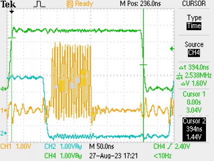

Increased setup/hold to 10:
CSINTERVAL=2, TCSH=10, TCSS=10
Slowed down and more front/back porch for CS shown.
Here's the interesting part: when I increase the setup time, the overall time increases with it, as I'd expect. But when I increase the hold time, it pushed out CS, but doesn't impact the overall time at all. It even returns with CS still low.

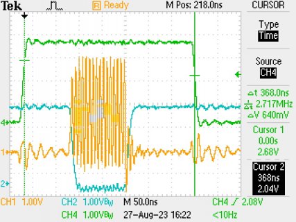

CSINTERVAL=2, TCSH=31, TCSS=3

So, seems like these settings are fine. I guess the extra time spent is just overhead from the FlexSPI engine? Of course, if I remove the read setup/execution code, the pulse is about 4nS wide from SW and on the scope.
Happy to try other experiments if you have other ideas, but guessing it is what it is...
