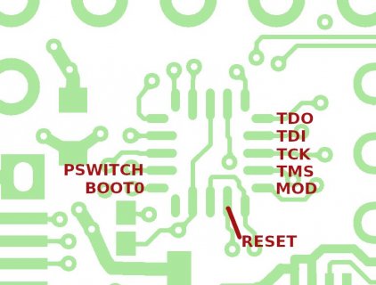

My goal is to desolder U2 and provide and add SWD capability to the board. Therefore, U2 pinout is important to me.
Teensy 4.1 uses JTAG, not SWD. It would in theory be done if you solder more wires and use a JTAG adaptor. Just know that SWD can not work.
If you do attempt this, here are the signal locations you'll need.
BOOT0 needs to be connected to GND for normal operation.
PSWITCH needs a low-to-high transition to turn on the 1.15V DC-DC power supply for the CPU.
MOD controls which JTAG device you access, either ARM debug or standard boundary scan. See the reference manual & datasheet for detail.

SWD absolutely will not work. All Teensy 4.1 boards are permanently fuse configured for JTAG. NXP did not implement dynamic switch between SWD & JTAG as ARM's documentation says. It will only talk JTAG because the fuse is permanently set to configure for JTAG only.
See the fuse map documentation in the reference manual if you need more info about this.
Maybe not the answers you wanted, but hopefully this gives you the info you need to get started, rather then wasting a lot of time on reverse engineering.
Another gotcha is PSWITCH. It will not work if simply wired to 3.3V. NXP's documentation about this quite misleading. It's not a simple active-high enable. A low to high transition is required (after 3.3V power is stable) to get the DC-DC converter to turn on.
You can find detailed documentation on the power up sequence on this page. Look for the schematic with buttons to highlight each power up step.
https://www.pjrc.com/store/ic_mkl02_t4.html
Once you remove U2, you'll lose step #7-8. Before you can even attempt to use JTAG debug, you'll need to create circuitry to drive PSWITCH to cause the CPU power to turn on.
Obviously you should only attempt JTAG communication after the CPU power becomes stable.

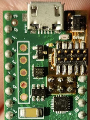

Sorry if my previous experience caused me to provide incorrect information. I was still working with the MKL02 at the time but I had not experienced the blink codes until then, I was under the impression that the software changed in some way that cutting the JTAG connections may affect the power up sequence. It is very possible I had a bad connection somewhere.
I have connected JTAG to a Teensy with a GD32 chip, but I am still removing the chip completely as I did before and driving PSWITCH and a few other pins myself. Since I switched to my new method I did not have a reason to go back and find my fault.
Here is one of my Teensy with the MKL02 footprints. I have a new PCB made for the GD32 footprint but I have not been able to test it yet.

I have not shared the files for this version yet. I intend to share everything once I feel it is at a point where someone can easily install it, hopefully that will be very soon. I will also look into reusing the bootloader now that I know it should not be an issue.
The 6pin chip is an ATTINY10 microcontroller, I make use of every pin to change modes, reset, and power up.

Results so far:
1. GD32 simple mod with cutting the pcb wires works. Not easy, but feasible.
!!!! There is no hidden problem with the G32 !!
2. The mentioned problems above have to do with the configuration of platformio and CLion or the IDE integration. I posted the problem there.
3. platformio debugging on the commandline works with the gdb excellent with JTAG. This was the main goal.
