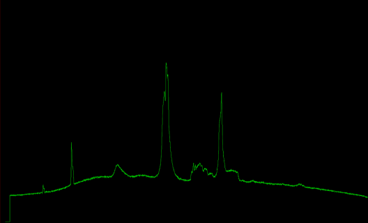

This is what I have so far. With a VB.Net test program I can actually already see the data of the photodiodes and display it as a curve.
Unfortunately, the AnalogRead function is so slow, that at the moment I only read every 16th diode, and on the next pass the next diodes. Always in the distance of 16 diodes. So 0,16,32... 2,17,33... 3,18,34 etc. I send these data so far as compound string "Number_of_DiodeSPACEAnalog_ValueCRLF".
In the VB program I split this string again the number of the diode is the index of an array, and the analog_value is the value.
What else can I do to make the reading of the analog value faster?

I am now quite satisfied with the development of my spectrometer.
The program examples that I found here or on the Internet didn't help me much because I didn't understand most of them.
I don't read out the chip's pixels linearly because I couldn't do this at the speed specified by the chip. That's why I let a random time elapse after transferring the data to the PC.
This means that the pixel data is also sent to the PC in a random pattern. But that doesn't really bother me.
So far I have transferred the data as strings.
The diode number, a space, then the measured value + CRLF.
This is done via the virtual serial interface. I have read that Teensy is also able to send the data directly to the PC via USB.
Would that increase the speed?
(The programming effort for this seems a bit high to me).
