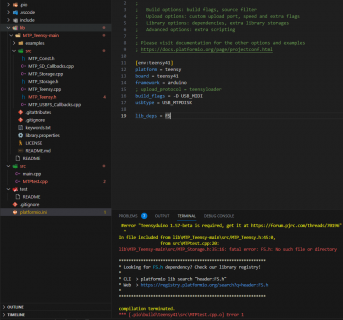

1. FS.h: No such file or directory
I could download any FS.h library from anywhere, but before that, I would like to make sure where I need to acquire FS.h library to avoid library collision.

But I don't know what I need to change its mode in platformio environment
Through googling, I got to know that there is an option as usbtype = USB_MTPDISK so i adopted it, but please let me know it's correct or not

1. FS.h is found in cores/teensy4/FS.h
2. Correct

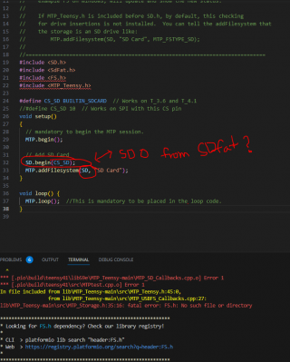

#include <Arduino.h>
#include <SdFat.h>
Teensy's implementation of SD is a very thin layer directly calling SDFat. You should look at the SdFat_Usage example to see how you can make direct SDFat calls using teensys SD but you might not need to.

1. FS.h is also found in cores/teensy4 but it isn't compiled and gives error. Should i add fs.h by myself when I use platformio?

3. Let me see through.. I understood that SD.h is required for using MTP example code since as below.. Can i perform the same function by using SDO.begin()?
Sorry, I am not a PlatformIO user so not much help, but:
1) Sounds like a dependency issue. Like somewhere, there should be on the command line that compiles the files, needed to add the -I for where the Teensy core is located.
For example using Arduino 2.1 the compile lines include:
"-IC:\\Users\\kurte\\AppData\\Local\\Arduino15\\packages\\teensy\\hardware\\avr\\0.59.2\\cores\\teensy4"
3) MTP code works using File systems as defined in FS.h so those native to sdfat can not be added to the list of file systems that are exposed by MTP. At least not directly. That is you could write your own simple FS wrapper object that forwards things to SDFat. But that is just recreating SD library.

Please include the entire terminal output when you try to build your code so we can see the complete system settings that your version of PIO is using. Also include your platformio.ini file as well which is very important.
