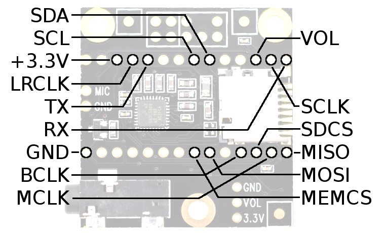

as with every "serial" connection that is labeled RX or TX, there is a tendency to confuse who is actually receiving or transmitting the data.
In case of the teensy audio adaptor, this is also the case for the I2S RX/TX pins.
This RX/TX situation is easy to get from the implicit (though technically not guranteed) I2S 'master' role of the teensy on the pin usage overview picture:

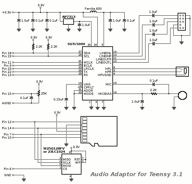

BUT: the following schematic centering on the audio chip uses the same teensy-centric I2S RX/TX identification for the internal chip pins without a teensy in sight and is therefore misleading.
The I2S data lines come from the left, pin 22 going to the internal pin26 as well as Pin 13 going to the internal pin25, and they are mislabeled on the SGTL5000 block.
As can be seen in the datasheet (page 3, top right), the internal pin26 is actually I2S_DIN (instead of 'TX') and internal pin25 I2S_DOUT (instead of 'RX'), and using those names would remove the confusion.
I'm only mentioning this error in such length because it's a treacherous trap for anyone building experimental I2S configurations, and it would take hours to find.
