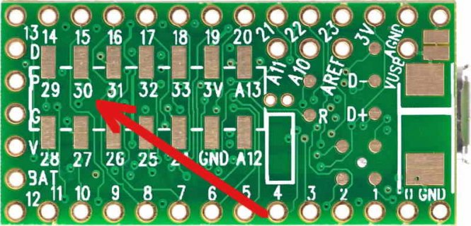

Probably your best path is trying to use the other I2S receive pin. Normally, we receive I2S on pin 13, with is native port PTC5 (the pin mapping is on the schematic). If you look at the giant pin features table in the Freescale reference manual, on page 209 you'll see the ALT4 function of pin PTC5 is "I2S0_RXD0". If you look down a few rows, you'll notice PTC11 (which is pin 30 on the bottom side of Teensy 3.1) has ALT4 function "I2S0_RXD1".
I2S0_RXD1 is by far your best chance to receive 4 audio channels using I2S protocol. I'm going to mention a couple other ideas that are not nearly so good, but please understand I2S0_RXD1 is almost certainly the best way.

Of course, I2S0_RXD1 is just sitting there as ALT4 functionality on pin 30. So far, nobody has tried to actually use it (at least nobody who's told me... admittedly, quite a good number of people use Teensy to make proprietary projects). According to the reference manual, I2S0_RXD1 certainly seems like it could be used to get 2 more channels, as long the same MCLK, BCLK and LRCLK can be used. The obvious caveat is this wants to be I2S master mode (where Teensy creates all the clocks)... it couldn't possibly work where 2 different I2S chips each create their own BCLK and LRCLK that aren't in sync with each other.
The latest version of the audio shield has pairs of solder pads to cut apart for the I2S RXD and TXD signals, and a set of 3 pads that can be cut and soldered to reconfigure the SGTL5000 for a different I2C address. The idea was to someday experiment with using 2 audio boards, for 4 channel input and 4 channel output... where the 2nd board would need some wires added from those pads to route its RXD signal to pin 30, and its TXD signal to pin 15.

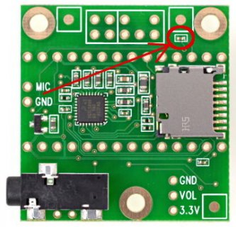

Is it correct that, in order to use two audio cards, I have to cut the traces in RX/TX/ADDR lines, solder ADDR to 3.3V, attach two wires to RX/TX and connect to the I2S RX1/TX1 pins at bottom of Teensy?
Yes, correct, except I2S TXD1 is reachable on both sides; it's pin 15.
I2S RXD1 is pin 30, only accessible on the bottom.
You also need to remove this tiny 0.1 uF capacitor on both boards, because it's connected to pin 15.
Of course, this is only the hardware side. Much work is still needed in the software to enable this to actually work.
Paul, only to double check
I have using Freescale Ref. manual V1.1
RXD0: PTC5 Pin13
RXD1: PTC11 Pad30
TXD0: PTC1 Pad22/A8 or PTA12 Pin 3
TXD1: PTC0 Pin15/A1
TXD0 has two options (Pad and Pin)
of course, Pins can be accessed from both sides, but Pads only from below.
