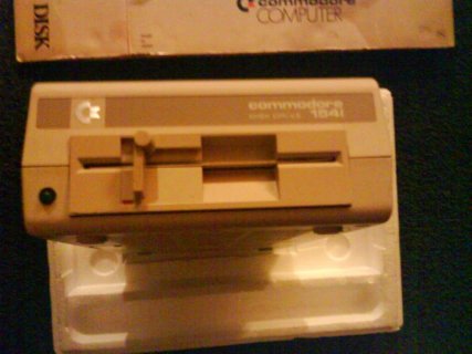

At the moment, i use a pretty simple method and a fixed #define in the main sketch that loads the PRG file and "injects" it into the virtual c64-RAM (after reset)
My plan is to support T64 (=tape) files at least (for the first release). It seems to me that this is the simplest file-format ?
Later, if ever, i want to add (virtual) floppy support. And i think it's exact enough to speak with a real 1541.. (i don't have one, unfortunately)
