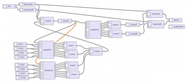

Suggested topology:
I guess for full fidelity you'd set the sample rate to 48kHz and then bitcrush to exactly 16kHz / 11 bit.
I sample at 44.1 and use this - a port of a part of the Mutable Instrument Plait euro rack module to simulate the sample rate + some extra bit crushing.
On the topology you need another tap on the main delay for feedback (you'll see why I made it 10 taps!) and the LFO pairs run in anti-phase (tap1+ve tap2-ve etc.). The patent is a good read as is the service manual.

Isn't the feedback just the mix of the 16-tap delay? I know the hardware has the Reverb / Echo selector, but that'd just be a parameter change for the Teensy. Looking at scope photo #5 in the service manual, you can see RAS/CAS pulses for the ADC write, followed by 24 more for the tap reads:

The anti-phase LFOs are (as of this morning!) catered for within the modulated delay object - just set modulation input 2N to +4ms depth, and 2N+1 to -4ms depth, and use full-scale triangle LFOs so they go from -1.0 to +1.0. The calculation is done per-tap anyway within the object, and it saves having to add 8 amplifiers with -1.0 gain.
I'm sure the original has a dedicated echo feedback tap but you might be right that you could double duty one of the reverb taps.
That's nice on the negative modulation, a couple of questions on your modulated delay object: would it work on a teensy without external memory? what sort of frequency do you think you could modulate up to, is there a practical limit (I'm looking at another vintage digital effect - a Lexicon SPT97 - and looking to modulate from 0.5x delay time to 1.5x at a rate from 0.05Hz to 500Hz)?
