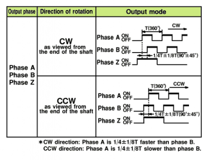

The spec page of the Omron rotary encoder shows this:
You stated
The rotary encoder is powered by a 5 volt source, and outputs a 5 volt signal. I am translating that signal to 3.3 volts to be compatible with the Teensy input limitations.
Since the encoder output pin is an open collector, I don't think it actually outputs 5V.
You only need to pullup that pin [which you do by "pinMode(encoderA, INPUT_PULLUP);"] and then read the pin. No additional logic needed.

Thank you for your quick response. I ran the sketch you sent and confirmed that attachInterrupt was indeed working on my Teensy 4.0. Sorry for the false alarm. I had been trying to do something similar to what your sketch does, but using an external LED (attached to pin 4) and setting that pin HIGH and LOW – the problem was the transition was so quick that it was not visible to the human eye. Just to clear up any omissions from my original post, I am using 10K pullup resistors on the outputs of the rotary encoder and I am using a bi-directional logic level shifter that I purchased on EBay to do the voltage level translations. Thank you, once again
The nice thing about the open-collector outputs of the OMRON E6B2-CWZ6C Rotary Encoder 1024P/R, is that you don't need 10K pullups resistors and/or logic level shifters.
Just connect the output pins of the decoder directly to the Teensy pins without any additional parts.
These commands will pullup the signal internally on the Teensy to 3V3:
pinMode(encoderB, INPUT_PULLUP);
And this command will thus read the pin at the correct voltage level of 3V3:
attachInterrupt(digitalPinToInterrupt(encoderA), encoderISR, FALLING); // pin 2
This saves some parts...
