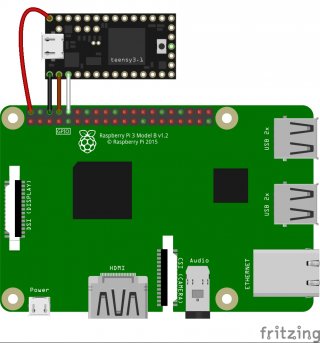

Combining teensies with the Arduino Yun
First try USB-Bridge between teensy 3.1 and RPi (jessie)
I found some time to play: I installed the newest Bridge on my Arduino IDE 1.0.6, installed the bridgeclient on the RPi (running jessie) as described on github. I also connected a FTDI-cable to have at least some output from the teensy over Serial1 and connected the teensy 3.1 and the RPi using a standard USB cable. When running the following sketch
  Running process using Process class.
 This sketch demonstrate how to run linux processes
 using a Teensy3.1 and a Raspberry Pi B (jessie) - much alike the setup an an Arduino Yún, but more powerful.

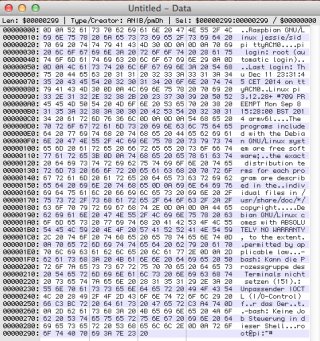

I'm a step further. When I use the following script to see what happens at Serial (USB), I get the response below.
Script:
  Serial1.begin(57600);
  delay(3000);
  Serial1.println("Started...");
  static int count = 0;
  if (Serial.available()){
    Serial1.print(Serial.read(), HEX);
    Serial1.print(" ");
    if (count++ == 16){
      Serial1.println();
      count = 0;
Output:
Started...
D A 52 61 73 70 62 69 61 6E 20 47 4E 55 2F 4C 69
6E 75 78 20 6A 65 73 73 69 65 2F 73 69 64 20 70 69
20 74 74 79 41 43 4D 30 D A D A 70 69 20 6C 6F
67 69 6E 3A 20 72 6F 6F 74 20 28 61 75 74 6F 6D 61
74 69 63 20 6C 6F 67 69 6E 29 A D D A 4C 61 73
74 20 6C 6F 67 69 6E 3A 20 54 68 75 20 44 65 63 20
31 31 20 32 33 3A 33 31 3A 34 35 20 43 45 54 20 32
30 31 34 20 6F 6E 20 74 74 79 41 43 4D 30 D A 4C
69 6E 75 78 20 70 69 20 33 2E 31 32 2E 32 38 2B 20
23 37 30 39 20 50 52 45 45 4D 50 54 20 4D 6F 6E 20
53 65 70 20 38 20 31 35 3A 32 38 3A 30 30 20 42 53
54 20 32 30 31 34 20 61 72 6D 76 36 6C D A D A
54 68 65 20 70 72 6F 67 72 61 6D 73 20 69 6E 63 6C
75 64 65 64 20 77 69 74 68 20 74 68 65 20 44 65 62
69 61 6E 20 47 4E 55 2F 4C 69 6E 75 78 20 73 79 73
74 65 6D 20 61 72 65 20 66 72 65 65 20 73 6F 66 74
77 61 72 65 3B D A 74 68 65 20 65 78 61 63 74 20
64 69 73 74 72 69 62 75 74 69 6F 6E 20 74 65 72 6D
73 20 66 6F 72 20 65 61 63 68 20 70 72 6F 67 72 61
6D 20 61 72 65 20 64 65 73 63 72 69 62 65 64 20 69
6E 20 74 68 65 D A 69 6E 64 69 76 69 64 75 61 6C
20 66 69 6C 65 73 20 69 6E 20 2F 75 73 72 2F 73 68
61 72 65 2F 64 6F 63 2F 2A 2F 63 6F 70 79 72 69 67
68 74 2E D A D A 44 65 62 69 61 6E 20 47 4E 55
2F 4C 69 6E 75 78 20 63 6F 6D 65 73 20 77 69 74 68
20 41 42 53 4F 4C 55 54 45 4C 59 20 4E 4F 20 57 41
52 52 41 4E 54 59 2C 20 74 6F 20 74 68 65 20 65 78
74 65 6E 74 D A 70 65 72 6D 69 74 74 65 64 20 62
79 20 61 70 70 6C 69 63 61 62 6C 65 20 6C 61 77 2E
D A 2D 62 61 73 68 3A 20 4B 61 6E 6E 20 64 69 65
20 50 72 6F 7A 65 73 73 67 72 75 70 70 65 20 64 65
73 20 54 65 72 6D 69 6E 61 6C 73 20 6E 69 63 68 74
20 73 65 74 7A 65 6E 20 28 31 35 31 29 2E 3A 20 55
6E 70 61 73 73 65 6E 64 65 72 20 49 4F 43 54 4C 20
28 49 2F 4F 2D 43 6F 6E 74 72 6F 6C 29 20 66 C3 BC
72 20 64 61 73 20 47 65 72 C3 A4 74 D A 2D 62 61
73 68 3A 20 4B 65 69 6E 65 20 4A 6F 62 20 53 74 65
75 65 72 75 6E 67 20 69 6E 20 64 69 65 73 65 72 20
53 68 65 6C 6C 2E D A 72 6F 6F 74 40 70 69 3A 7E
23 20
When I look at it in my hex editor, I get the following:
hex_response.jpg.
So it seems, as if the RPi has trouble, setting a few things:
(-bash: Kann die Prozessgruppe des Terminals nicht setzen (151).: Unpassender IOCTL (I/O-Control) für das Gerät
-bash: Keine Job Steuerung in dieser Shell.)
that means in english
(bash: cannot set terminal process group (151): Inappropriate ioctl for device
bash: no job control in this shell)
Does anyone know, what bash might mean by that?

Nuage works quite well with a Raspberry Pi 3 and a teensy 3.1 using Serial1. Of course teensy 3.1 cannot be (re)programmed over Serial1. Would it maybe be possible to reprogram one of the newer Teensies (3.5/3.6) over serial, so that the combination of the two systems would be a real alternative to an Arduino Yun?
Thanks, Dani
