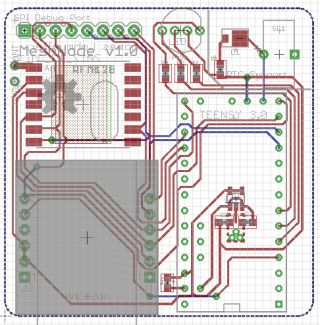

Btw, my RFM12B to Ethernet bridge is already working reliable on breadboard. I'm currently pushing received wireless data to a Redis server over Ethernet. Look like I'll have to order some more Teensy 3.0's soon ;-)
I don't use Eagle, so no, sorry, no Eagle files.
Here is a newer version via OSH Park design sharing.
http://oshpark.com/shared_projects/LOt9A5hs
That first board lacked a way to reset the W5200, which really turned out to be necessary. This newer one connects the reset to pin 9. If you order some of these from OSH Park, please let me know when they arrive. I'll try to gid up the experimental code for it...

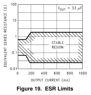

The minimum output capacitance required to maintain stability is 33 uF (this value may be increased without
limit). Larger values of output capacitance will give improved transient response.
ESR LIMITS:
The ESR of the output capacitor will cause loop instability if it is too high or too low. The acceptable range of
ESR plotted versus load current is shown in Figure 19. It is essential that the output capacitor meet these
requirements, or oscillations can result.
