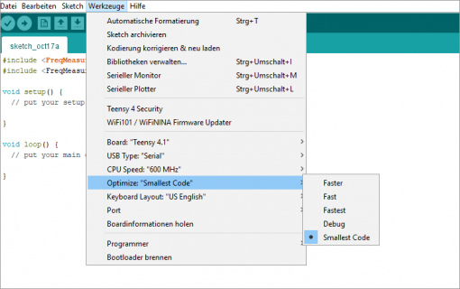

BTW: Did you try to switch to nanolib? You can easily test this by using the Optimize for smallest code option.
Thank you very much, luni, for the info regarding nanolib.
Please, excuse for the stupid question - I tried to find myself how to enable nano-lib in arduino/teensyduino environment, but failed. Please, suggest me should I install VisualTeensy? Does it work on Ubuntu?
Regarding to code optimization. I have some parts of my code that are sensitive to optimization option. So, as I see right now, about 30Kbytes of my code should be fully optimized and situated in ITCM or cache, and the rest (ca. 70Kbytes) - is just setup and I/O that executes at begin/end of application and its performance does not matter for me. The total memory usage is actually critical for me, I used hierarchical access to slow psram and dmamem, and fast DTCM, and all DTCM is right now occupied.
Is there possibility to compile one part for -O3, and other parts with -Os? Actually I am very beginner in teensy's - the T4.1 is my first board from this series, so, please, excuse me for stupid questions.
As mentioned above, just choose Optimize "Smallest Code"

If this brings the size of your sketch far enough down you can selectively enable optimization by using #pragma optimize (see e.g. https://stackoverflow.com/a/2220565)
#pragma GCC push_options     // this stores the current settings
#pragma GCC optimize ("O3")  // change to level O3
void myFastFunction()
void anotherFastFunction()
#pragma GCC pop_options      // restore old settings
Using the IDE setting smallest code not only changes the optimization level to -Os but also links in nanolib instead of newlib which usually brings down the code size significantly. Using #pragma GCC optimize ("O3") on a project built with IDE setting "smallest code" will use nanolib with highest optimization level.
Thank you very much, luni! Your kind advice finally solved my issue!
By using your suggestion, the total code size dropped from 101K to 63K that saved me two 32K blocks in ITCM, and, in addition the nanolib requires less internal variables, that saved additional 4K in DTCM.
Super! Thank you very much!
