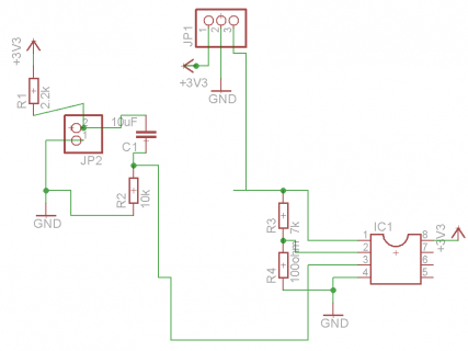

Can you post pictures or a schematic.
What are you microphones and how are they connected? What voltages do they swing to and from. If you have an oscilloscope a picture of this in action would be good but if not a part number would suffice.
If you're only after detecting loud sounds a peak detector maybe worth considering. This is a hardware solution though and I strongly believe this can be done internal to the Teensy using your prior described ADC option
Well, its 4* electret microphone - i have built a circuit that gives me up to 3.3v from the microphones, and i have tested that they work on the oscilloscope, can post pictures soon.

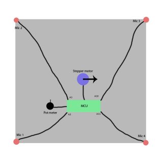

the output i want from the microphones i some kind of array with values, so i can identify the peaks from their value and compare the time diffrence (based on sampling rate)
here is quick schematic from the microphone schematics where jp2 is the microphone and ic1 is a op-amp mic.PNG
That's for the comprehensive images!

What is the distance between microphones?
Yeah, but Im not sure if it will sample fast enough for me - i need to sample enough to read values at a good bit faster than 1.47058824 milliseconds - the faster the better - my project is all about the delay in sound between the 4 microphones
gunshot direction detectors use low microseconds per sample. Speed of sound at sea level nominal is 768mph (340 m/h). Divide that out to get ft/sec or m/sec
it is precisely what i want to measure - my distance is 0.5m between the microphones - Do you have any introduction to DMA? have no idea what it is?
OK, 0.5 m means in air you need a buffer of 2 ms (at least for diagonal distance). I would add some extra delay to be sure you catch all events in a single block. Now, if you wanted to use 256 point radix 4 FFT for cross-correlation, you need to sample your data with 256 kHz, which is very high indeed, but feasible, but only with Direct Memory Access (DMA), where ADC writes directly into memory and launches an interrupt when finished.
Real time processing is not a problem - want it to run a trigger (a threshold) and if the soundlevel passes the threshold, it will sample for a short periode of time and then it will pause the sampling and calculate the stuff i need
Yes, in the interrupt service routine, you can check first the max level, and do cross-correlation only on demand.
This is what would I do for direction finding.
Why not take 4 pins of the FTM0 in input capture mode, and drive these from simple comparators/schmitt triggers between the microphones and the pins? This will allow to resolve time differences with a resolution of 20.83ns (assuming F_BUS is set to 48Mhz) which theoretically allows measuring distances down to about 7um if the sound speed is 334m/s. Example code on how to use the FTM0 in input capture mode can be found for example in the FreqMeasureMulti library which would naturally have to be adapted for that purpose. But very easy and without ADCs and FFT...

I have 4 microphones that i have passed through 4 comparator so they will emit a 3.3v pulse when sound is detected.
Now i will need to measure the diffrence - since i have 4 microphones that i want to measure - should i use some specific Pins on the board to spread out the microphones?
also to count the diffrence, how will i do that? i found this: https://github.com/cTn-dev/Phoenix-...ibraries/P_Receiver/Receiver_teensy3_HW_PPM.h
but it seems like it is only for 1 pin and not 4 like mine.
do you have any code example for setting the 4 channels up and how to "read" the value?
