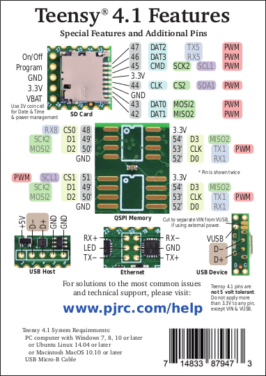

Question to the forum: Is it possible to set up the built-in SD card pins as digital outputs, so I can try high frequency switching on those lines without the SD or SDFat libraries?
Thanks, Defragster!
I configured each pin as OUTPUT, and set PWM frequency to 1MHz.
Then, while a zero-amplitude sine wave was playing, I set each builtin-SD pin to 50% duty cycle for a 3ms interval every 100ms.
I captured the Teensy Audio Board output with my NI USB-6211.
Here's the result:
Looks like Pin44 (the clock pin), is the culprit.
Here's the Arduino code I used (manually modifying 'currentPin' for each acquisition session):

It looks like pin 44 is the CS line for the second SPI bus - which should have far fewer transitions in theory. Can I interface with the built-in card via SPI?

Yes, use more relaible connections - plug the shield directly on the Teensy - , don't use these china wires ;)
As Pin 44 is the SD clock pin, SPI wouldn't help.. needs a clock, too.
Or try the SD on the shield?

From the pinout diagram, it looks like pin 44 is a clock pin for SDIO mode (light blue) and a chip select pin for SPI2 bus (green). The CS line toggles far slower than clock - so if I could initialize the SD library in single bit mode using SPI2, it might reduce the magnitude of interference.
I'm not sure why nobody has seen this, and I'm doing my best to sanity check it. Possibly most users opt for T3.2 and T4.0 with the audio shield, and use the shield's onboard microSD card?
Hm,
no, for the SD it's always the same pinout (for clock)
SPI-Mode:

OK, maybe it's a typo in the pinout diagram. I was hoping not!
