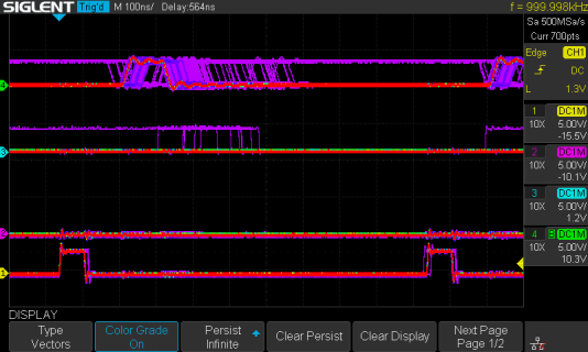

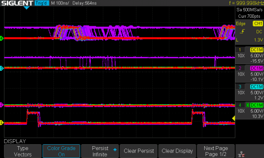

Here is a screenshot from the scope showing the test pins (yellow = ISR, green = process sample, blue = Serial2.write):

To my surprise changing to digitalWriteFast made a huge difference, increasing the performance by nearly 300%.
I will try the DMA_UART too and report back. The green test pin is so fast now my scope can't even capture it anymore :D probably need to use the little ground spring at this point.
On a side-note I've been really impressed with the Teensy 4.1. I originally started with an ESP32 and it was hopeless. Then I tried a Teensy 3.2 that I had laying around and I got the 1 µs interrupt to work but there was no time left for processing but still impressive. Then I bought the Teensy 4.1 and yeah, just really impressive.

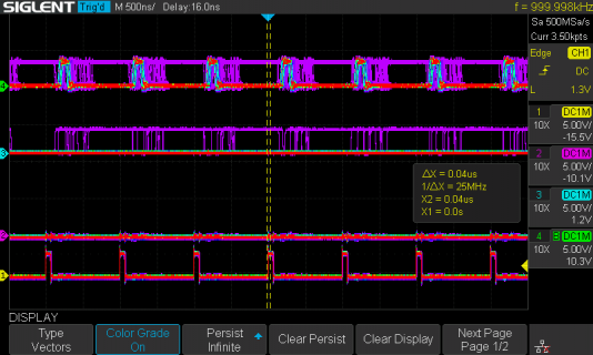

Here is a new screenshot, only changed to digitalWriteFast:

Thank you sicco so much! I tried your LPUART4_DATA, and I didn't think it could get much faster but it got way faster yet again, by 200%, wow.
I'm just so impressed with this little board that I bought 2 more because I'm sure I'll use them at some point, many thanks!
I have one more update, to show the effects of the timer interrupt priority. Below is the actual program that's performing work and without any of the optimizations implemented from this thread. Yellow is the ISR that is sampling the input pin, green is processing the sample, and cyan is writing data to the serial port.
The thing to notice is the irregular interval of the ISR which I can't have.
The ISR has a priority of 128 and the UART a priority of 64.
Now the same thing but the ISR priority was changed to 48:
They look perfect, and just to make sure I'm not seeing things, here is with persistent display turned on:
It's completely perfect as far as I'm concerned. I also tried priority 0 and it made even a slight bit better but beyond what I need so I will stick with 48 for now. This concludes what this thread was about and again many many thanks to you guys!
